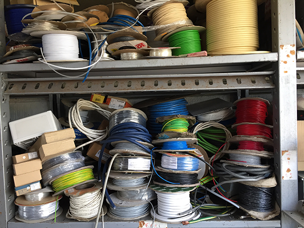

Or just stack them - I took that when I decided it was time to tidy the shelves up a bit..

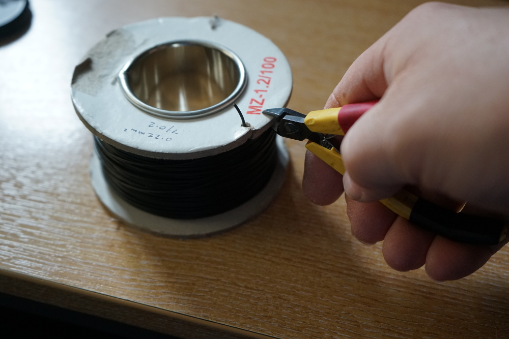

I use a variation of that technique for reels of "hook-up" wire.
Use wire cutters to make a slit in the cardboard end cheek of the spool.
The loose end of the wire can then be trapped into the slit.
Depending on the position of the free end of the wire, it may be convenient to make two or three slits around the circumference of the spool.
Like this:
That looks amazingly like my wire storage shelves where I used to work. I also did have a rack with dowels for my more popular spools. :)
