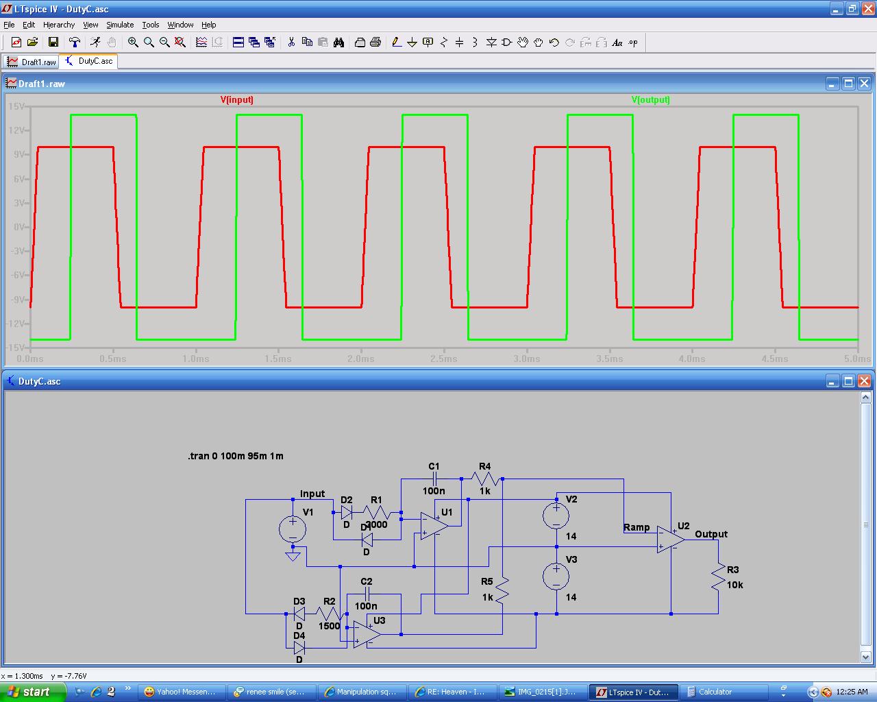

I have a square wave signal (50% duty cycle) with variable frequency and I want to control this signal to become square wave with 33% duty cycle in any frequency.

It seems easy, but it's not. Here is my effort. Essentially, U1 takes twice as long to ramp up as U3. Add the signals together, and you get a 1/3 - 2/3 duty cycle. U2 cleans up the edges.
I doesn't seem to simulate quite right. I think this would have to be built to tune up properly. It needs some more refinement. This is just an idea.

Maferic, after sleeping on it, I realize my circuit won't give satisfactory performance over your frequency range. Also, it will exhibit a little lag when changing frequencies, which may or may not be a problem. I think it can be fixed, but fixing it would at least double the number of components and quadruple the design effort. In the end, it probably won't perfrom any better than the PLL idea. Unless you just don't want to use a PLL, that's probably your best bet.
The simplest, most reliable solution is to get the motor to put out three pulses per revolution...
Any PLL solution always will have a lag as the frequency changes.
