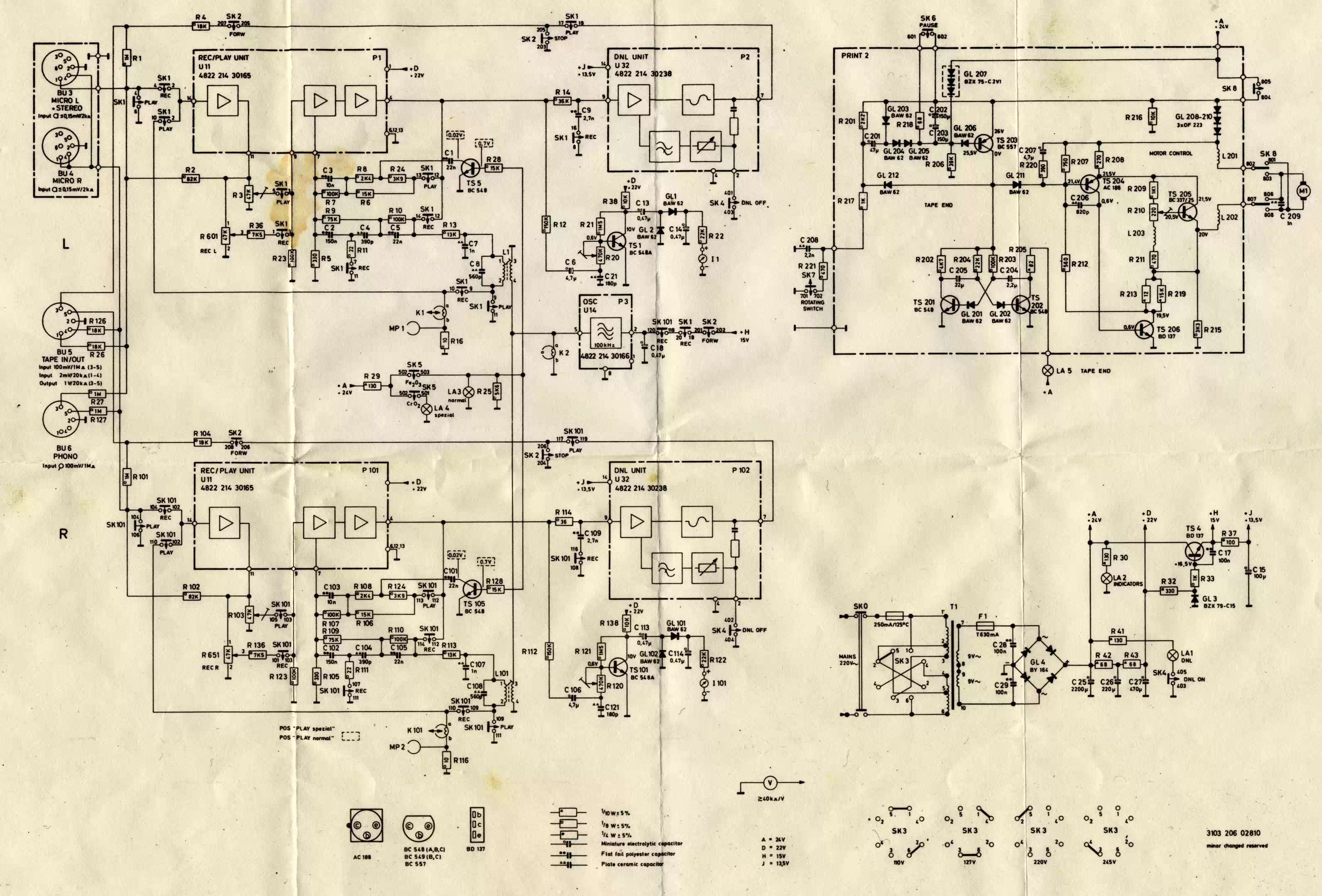

Hi.
I sort of having the oposite question of what is normal. I have the schematic but don't know what unit it belongs to.
I doesn't have more than the scanned image already show - nothing at the flip-side of the paper.
The schematic is scanned and saved as a webp file - give a reasonable file size and with a compression method that in my opinion is better suited for drawings that jpg.

Anyway - I've saved it as a jpg file and upload it now.

It's of a Tape Deck, using AC for Recording Bias and Erasure.
It uses European class of semi conductors - likely to be a German / Dutch / British equipment.
It's not British, most likely it's German, Dutch (Philips) or possibly from B&O?.
The circuit diagram is obviously from inside the unit, where it was folded up, the British never did this - as it would have breached BEAB approval - but it was commonplace from where I mentioned.
I just searched for two of the units from the circuit diagram 4822 214 30165 and 4822 214 30238 and came up with Philips tape recorders.

camerart is correct, in my view.
As a refugee from Philips, I can say that the code number system is according to the Philips 12NC coding system.
omg - thank you guys. I think I know one that have that kind of cassette player. If it isn't throwed away I will take a picture and see if it is that.
I think about the one where frame is partially wood, and where the cassette is loaded in from the top.
