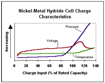

Energizer's website has a Ni-MH battery Applications Manual. It shows that their Ni-MH cells are fully charged at slightly more than their capacity then over-charging causes increased internal pressure and temperature.
They recommend sensing the voltage peak or sensing the temperature rise to determine that the battery is fully charged then turn off the charger or use a trickle charge current that is only C/40.

1. These are Duracell batteries
2. The amount of energy put into the battery can exceed the amount stored by 150%, therefore the amount of energy you put into the battery does not mean that is what its capacity is. In other words, if you push 1500 mah of energy into a battery, it may only store 1000 mah of it, the rest is lost to heat and other forms. I believe Energizer was simply saying that thier battery could have slightly more charge than is advertised, like having say 1050 mah stored when its capacity is 1000 mah.
You might be looking at the spec's of old Ni-Cad cells that needed 40% more time to be fully charged.
