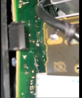

So I bought a Marantz NR1605 A/V off of eBay "as-is". The description reads:
Marantz NR1605 AV Receiver As Is, no returns or guarantees Shipped with USPS Parcel Select Ground. This was a new receiver purchased in approximately early 2015. The receiver still turns on but I think during a power outage/surge something happened to the HDMI in/out capabilities. The receiver is included with the adapter, manual, and remote control
They are correct - it does come on but only for a few milliseconds before turning off. I bought it thinking that it probably would just be a blown fuse or something I could see a burnt component on the board that I could replace.
Opening it up I found a total of 4 fuses. Each fuse looked just fine. Nothing blown. Examining the board(s) inside they all seem clean and shinny/new looking. Nothing on the board(s) look burnt or leaking in any way.
However, I am unable to figure out what the steps are in order to take each PCB board out in order to see what beneath it - if there are any more fuses or check for something burnt/leak.
I have taken a good amount of pictures in order to let you see what I am seeing. Perhaps you would be able to spot something that I have not. Or better yet, let me know how to go about taking the PCB boards out. I also have 2 videos showing it coming on and then off and also what it looks like on the LED screen when it comes on.

Based on your observation, since a least it seems to be powering up momentarily, the FIRST to check is to attempt the DIAGNOSTIC MODE(thru the front panel). Can you even go in to diagnostic mode?
(Starting from Page 19 of the Service man. attached)
Good Luck
WAIT A SEC!!! there is shipping damage shown on your video, the back panel is busted--perhaps this is secondary to the original problem? but it can certainly prevent it from powering up.

actually it's not a FPGA but there are two control processors (main processor and subprocessor) the processors are very rarely the problem. i worked on these a lot (and they are identical to many DENON receivers, with the only difference being the front panel exterior). if you have a broken front panel board, it's possible the two processors can't talk to each other. there are other things however that can cause immediate shutdown, but you probably can't do the diagnostic readout on the display if the display board is broken.
