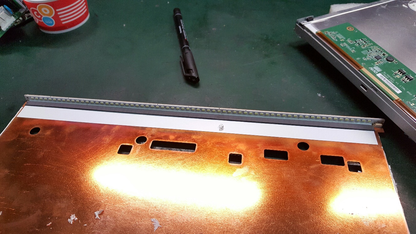

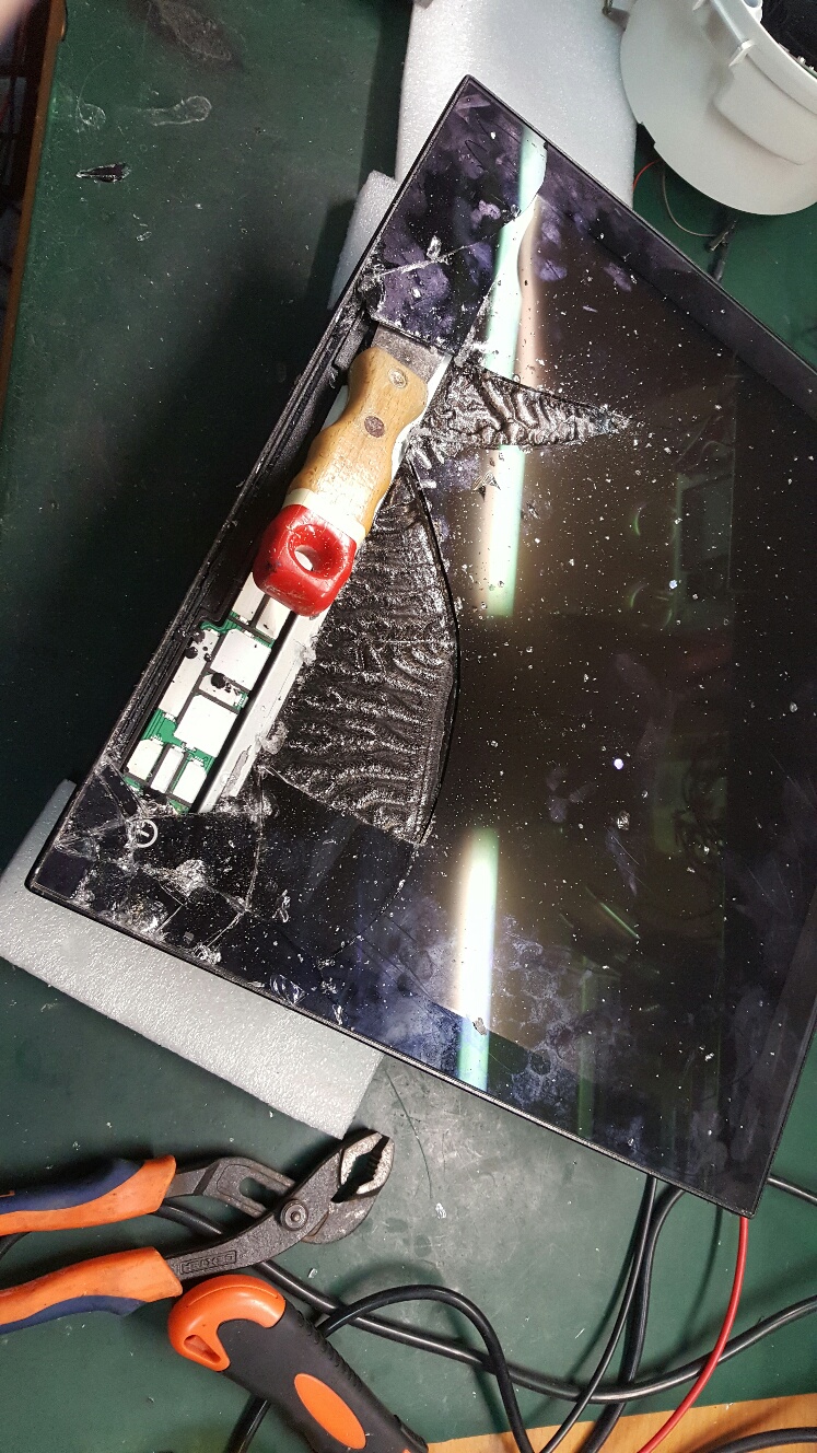

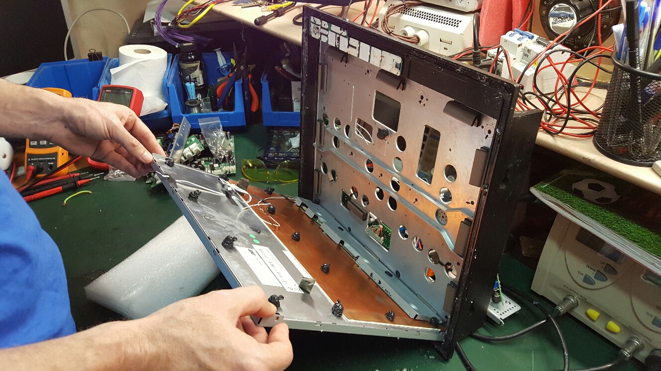

Thanks dr pepper. Finally I got access to the LED strip. I had to break the crystal of the screen, no other way to access as it´s in a metal frame all together with glue...

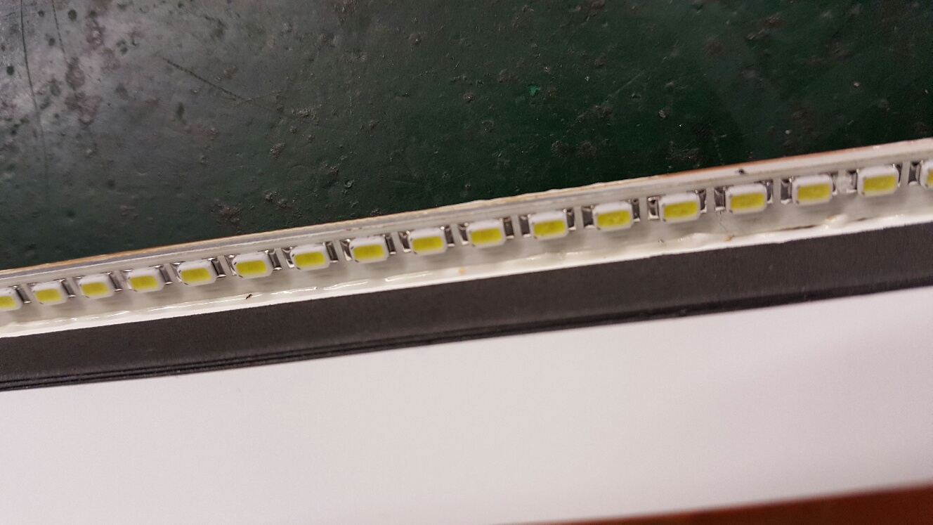

The driver is not the one used in the LCD itself, it uses one external so the LED bar I guess is also different. I have 66 LED in 6 group of 11 in parallel and when I give 3V individually to all of them they work. The capacitors at the output of the driver are 2 of 22uF 50V in parallel, so it has sense that 40V is the correct output.
Now the strange thing, when I give 40V power only some strip of 11 is lighting, only sometimes!!! If I measure with continuity to see connection to the connector and to the LED´s I can see how they are in parallel of 11 units so I don´t understand this behavieur. Some pictures attached.

Sounds like a case of dead bond wires, however that would mean some wouldnt work when powered individually, maybe a bad connection to the board or an open trace then.
Looks acedemic now though, with the glass broken doesnt look as though it'll work again, or do you have some idea of getting it back togther again?
Those led's are probably good quality ones wih matched intensity and colour temp.
Yes, for sure there are problems, bad contacts. About the crystal I can put a new one and the LCD I can buy too. I can repair those parts but now the problem is this LED bar without any reference on it... These displays are very expensive, they can be more than 5.000$, this is why I went so deep in the repair.
I'm surprised you can get the parts for it, I spose at that money some will repair them.
Maybe if you powered a strip then flexed it around with a 'driver and see if you can find an open in the board, on a board that isnt lighting if you set your power supply to current limit you could short out each led with a pair of bird beaks, when you get to the bad one the rest should light, assuming no more than one is bad.
If you replace any leds, colour temp match might ne an issue, maybe not so bad for just one or two.
