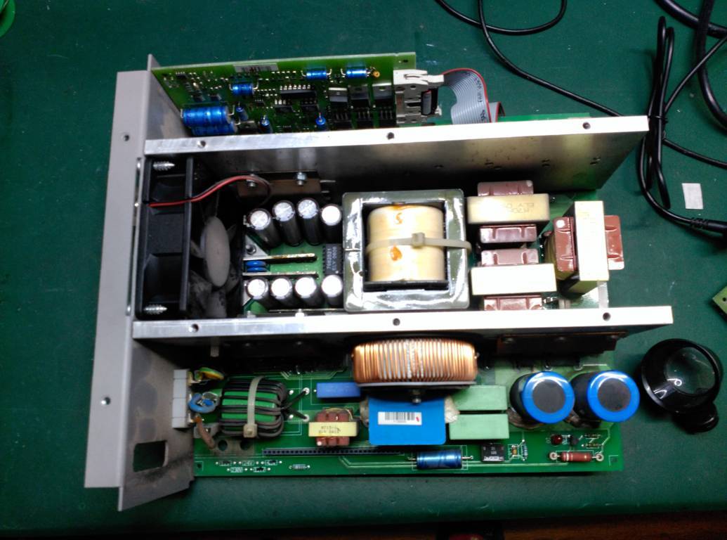

I have this inverter which the customer told me was failing since somebody connected a drill machine on it. He told me the output was more than 300Vac but when I connected the scope I see 310Vac peak to peak, 120Vac RMS and 50Hz frequency.
I have checked all components, diodes and mosfets, some capacitors and chokes, everything seems good. The only thing I see strange are typical horizontal electrolytic capacitors which have a little high D value and also ESR but they are in control circuit and I don´t see any overload at the DC power, I think it has more to do with some coil... Any ideas?
Have you tried putting a load on it and watching what happens?
Sorry, I should have said the expected output should be 230Vac, I have just the half of the expected voltage output
You know, I´ve seen the unit is marked as 24V input 230V output but I see erased the other options as 12V or 48V input and 127V output. This makes me thing about a problem at feedback or something like this to get as an standard output 120V, may be if it loose some feedback information it does that...
Yes!!! There is a transformer at the output with the primary in line with the phase, secondary is open and a resistor in parallel of 392 ohm also damaged, is showing me 15 ohm.
Now my problem, I think the transformers are always customized in these kind of equipments, I can see "M715-1 ELY 0612" written on it but nothing at Internet as usually. I´ve never tried to rewind them, is that possible? Any way to know the value?

If it was designed to be a 120 volt output and not a 230 volt one and was just mislabeled I don't see any point in trying to convert it over.
However if it is a 230 volt output unit and the voltage is too low the problem is likely related to the feedback circuit malfunctioning in one way or another.

Thanks Tony, but to be honest sadly I don´t have your school high level knowledge so many times I´m lost in your explanations. Sorry about that...
The output should be 230Vac but I have 120Vac, probably because the control circuit doesn´t get the feedback info through the output feedback transformer. Now I´m trying to get the transformer from other device from same brand, looking for same damaged device asking to other companies here at my island. Sometimes they keep them for spare issues.
