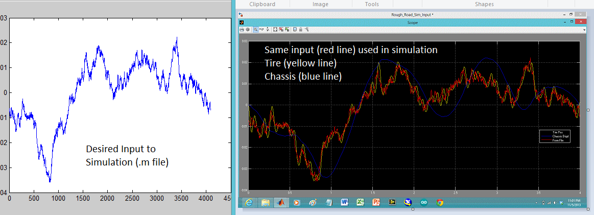

I am trying to use matlab's simulink to simulate a 1/4 car model suspension. I have managed to get a nice response of the chassis and tire position just using static inputs like a speed bump or by using a gradually increasing road frequency with a small amplitude. This type of simulation does not properly simulate real road patterns. I can simulate a 'real' road pattern by changing the input to something known as the inverse fourier transform of the power spectral density of the road.
My Question: How do I import the road_profile matrix that I created in the .m file into Simulink? Each time the simulation increments by one time step, the road_profile matrix must also be incremented as the correct input to the model. I have search extensively online for matlab support but could not find much.

There is 1D 2D 3D lookup tables within Simulink. Load the matrix into that with the simulation time (or "simulation increment") as the input to it.

After much ado, I have managed to figure out a solution. In order to index your matrix along with a simulation the sampling time and simulation increments must match.
First create the matrix using a .m file and use the save command as one of the lines of code. This stores a matrix in file form so that it is accessible to matlab. Use the 'from file' function in matlab to import your matrix into Simulink. The matrix that is imported must have a row vector at the top of the matrix with the indexed times for each sample. The Simulink file will run now. horaay! Check out my results for a random road input and chassis and tire response. Super cool.
Thanks to anyone who was helping. Best -t

Thanks Mister T, took me about 7 hours of trial and error and searching matlab documentation to figure this out. I am surprised there is not more info on it.
