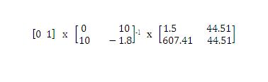

Hi all,
I having a problem on solving a matrix problem.
the equation is attached.
can anyone show me the step to get the answer for it?
Thanks.

I'll give it a shot.
[0 1] is a 1x2 matrix and [0 10; 10 -1.8] is a 2x2 matrix. Multiplying these together would result in a 1x2 matrix of [10 -1.8]. Multiplying that matrix by the last one would result again in a matrix of 1x2. Which is [-1078.338 364.982] I have it worked out, just waiting for my scanner to start working.

Did you notice the little -1 on the second matrix? It means "take the inverse". Anyway here is what I got using scilab.
-->A = [0 1]
 A  =
    0.    1.
-->B = [0 10; 10 -1.8
 B  =
    0.     10.
    10.  - 1.8
-->C = [1.5 44.51;607.41 44.51]
 C  =
    1.5       44.51
    607.41    44.51
-->B = inv(B)
 B  =
    0.018    0.1
    0.1      0.
-->A*B*C
 ans  =
    0.15    4.451
Same answer i get, and yes that little 'inversion' sign (-1) is hard
to see because it's so much smaller than the other text.
Using the notation:
[[a11,a12],[a21,a22]]=
| a11 a12 |
| a21 a22 |
Taking the inverse of B:
B'=B^(-1)= [[0.018,0.1],[0.1,0]]
D=A*B'=[0.1,0]
D*C=[0.15,4.451]
Ah, I see the inverse sign now. My bad; tried to do it in a hurry and over looked it. Good thing someone else replied.
