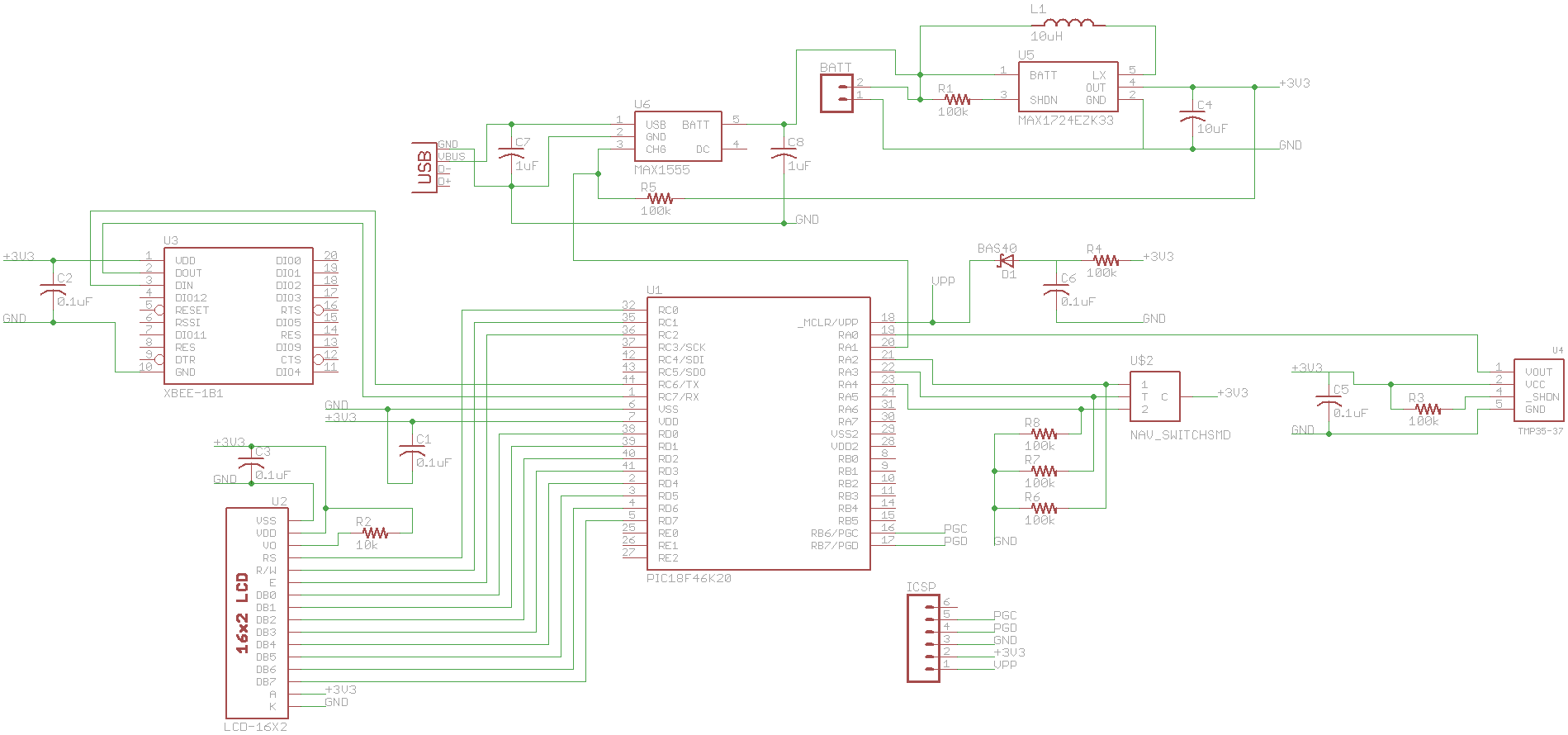

Has anyone used a MAX1555 with a significant system current draw?
I'm planning on using one to charge a battery in circuit via USB(see diagram below). I want to use my LCD output to display current charging information however I know that the PIC + LCD is going to be about ~25ma. Is this something I should worry about? I was thinking of going with just a simple SMD LED but those are still around 10-15ma.
