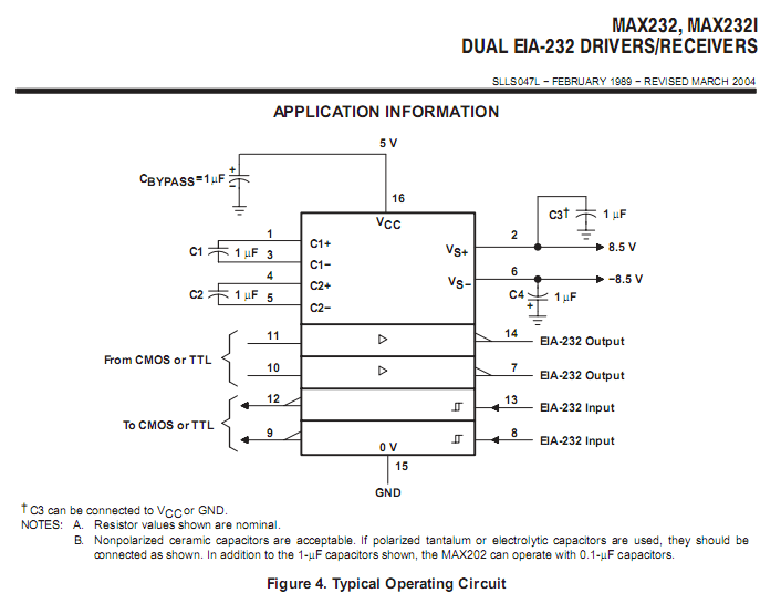

Hello all
I have used Max232 umpteen times.I know how to connect capacitors.
This time though ,it gets heated and eventually dies.This happens with all 232's
The power supply is 5v steady and stable generated from a 7805 and filtered appropriately.
Pin 2 is connected to 1uf electrolytic capacitor+ve and the -ve goes to Vcc=5v
Pin 6 goes to 1uf electrolytic capacitor-ve and the +ve goes to ground.
Other things are as in datasheet.
I checked TI Max232 and found out a startling thing.It says to connect
Pin 2 connected to 1uf electrolytic capacitor +ve and the -ve goes to GROUND
What could be wrong???
Expecting help as usual :)

This image shows how to connect the caps.
When you connect from from pin2 to +V, which way around are you connecting the cap.??
As pin2 is at a higher potential than +V
Hello eric thanks for replying
Now there's the problem
Since Maxim datasheet asks to connect the cap +ve from pin2 and the cap -ve to Vcc whereas the schematic you provided asks to connect the -ve to ground :confused:
I have been using the Max for a long time now and always connected from pin2 to +ve and the -ve to Vcc=5v
It could be a problem with the caps themselves, have you tried a different type/batch of cap.?
I have always connected pin2 as shown in the image,never had problems.
