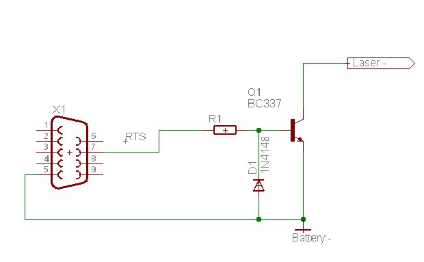

Now, I want to build a serial cable on/off switch for my laser-pointer based on the MBUS-cable-diagram.
How do I wire the MAX232, so I can send a command by the pc that turns the laser on or off, ie. continuos 3v or 0v are supplied ?

If you just want to turn something on and off using the serial port you don't need a max232. You can just use a handshaking line to control a transistor...
If you give a bit more information about the laserpointer itself i can make up a scematic...
(supply voltage, ... ?)

I'm sorry, but i'm getting errors when I try to upload the scematic, I'll try again tomorrow ...
The serial port can only supply a small current, certainly not enough to power a laser pointer, so you're still going to have to use the batteries...
Find the negative power supply in your laser pointer (the - that comes from the batteriers), cut this wire and connect it to the 'battery -' on the scematic. The 'Laser -' exit should then be connected to the other end...
I'm getting 9,8v on the 7th and 5th pin of the serial connector when it's attached to the pcs serial port, whether the your c program activates the RTS thing/line or not ...
Why ?
