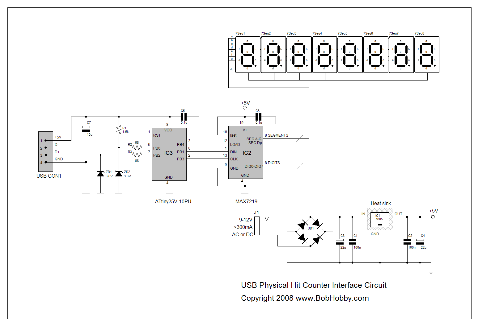

does it shows only one number at a time on all the 8 seven segment display or it shows different numbers on different displays(if so does it require any specific code to be written so that it goes to different displays?)

It shows one number at a time but switches between all the digits at a high frequency so it appears that all 8 digits are lit at once.
The code to drive these is pretty simple. The MAX7219 takes care of which digits are lit and when and what is on the display, all you need to do is write the code to tell the 7219 what to display (in the datasheet !!!)
I will warn you that they are expensive chips to purchase if you are planning on using them a lot.
Check out the MAX6951. It is an upgraded version of the part. You can find Maxim LED segmented display drivers here: **broken link removed**
