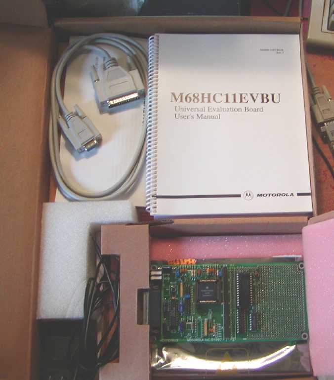

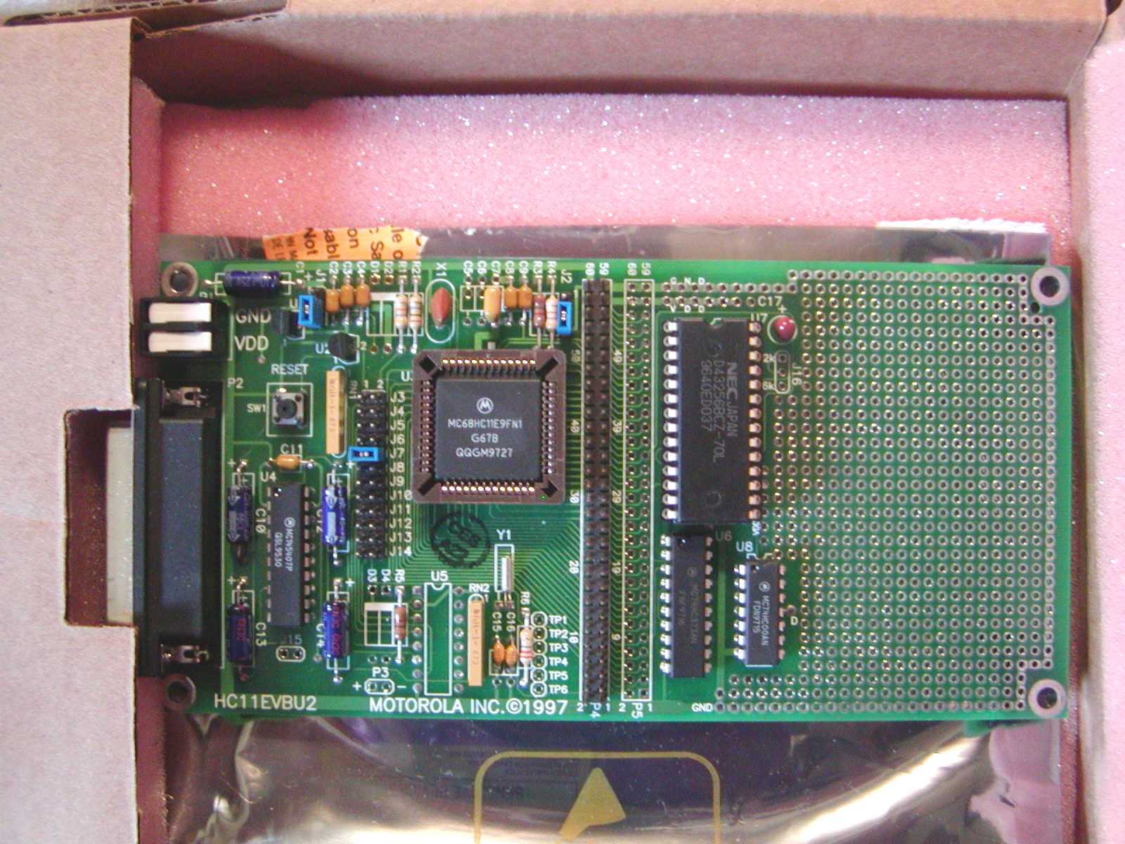

It's been a while since I did anything with 'HC11 or 'HC12 microcontrollers but I looked in storage and I found a very old unused 'HC11E9FN1' Evaluation Board Kit. I remember buying it "on sale" at the tail-end of one of the Motorola EVBU promotions many many years ago. It does include a version of the BUFFALO monitor for loading your programs into RAM via serial port but the "E9" will be different from "E1" variant.
Could you ask your instructor if this EVBU will do what you need for your class?
Regards, Mike

Thanks Mike for the quick reply,
I am sure this board will do the job, as long as I can run buffalo on this board its good.
Please pm me with the further info on this board, I mean if you want to sell this kit. Thanks again.

According to my pink 68HC11 book, the E1 is the same as the E9 except it doesn't have the ROM. That makes me suspect that the buffalo monitor was probably in ROM on Mike's board.
Here is an **broken link removed** which uses the chip in expanded mode to load the BUFFALO into an external RAM via the bootloader and run it from there.
The board Mike has have the E9 version and I think the buffalo is pre loaded on internal rom. The external memory is there to run your custom programs.
