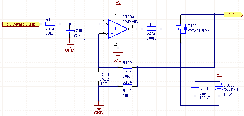

Here it is... I'm not sure if that's a good mosfet for the job, nor which opamp to use :( .. This is the "salvaged" schematic from piece of paper in my desk :) .. the mosfet and the opamp on the schematic are "approx" I'm not sure which ones to use
The circuit doesn't have a load and has no load current.
The Mosfet shorts 14V to 5V through its body diode.
The non-inverting input of the opamp is connected to +7V which might destroy it.
The Mosfet is tiny.
