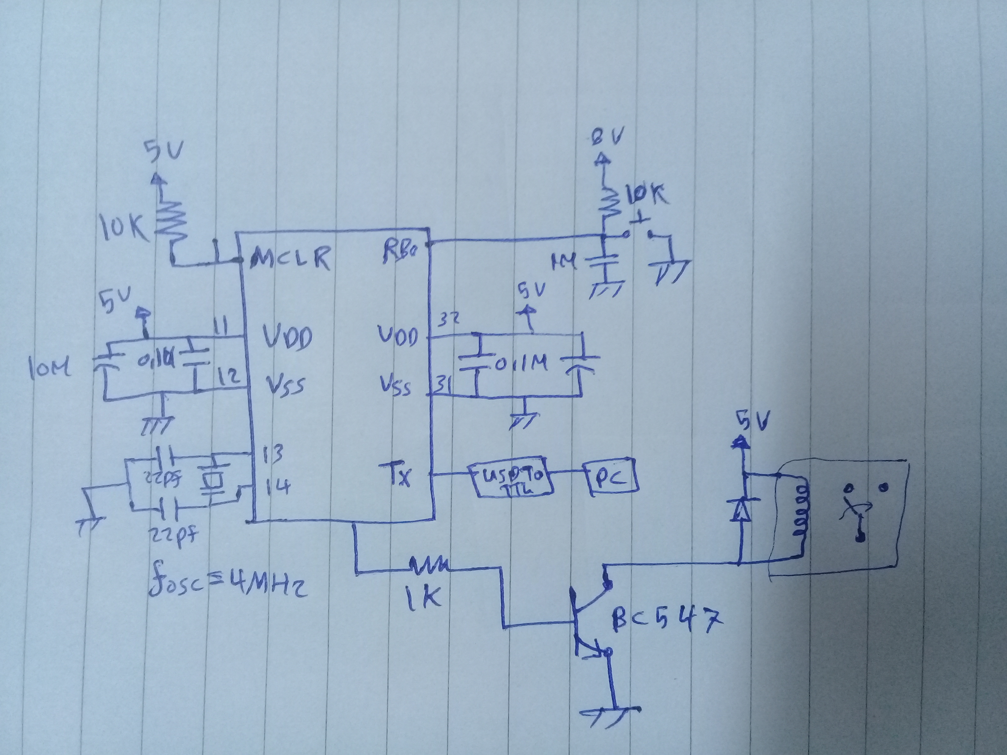

We especially need to see where the wire from the emitter of the BC547 is routed. Try lifting it, and return it all the way to the negative terminal of the 5V power supply.

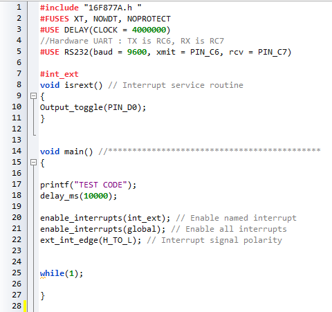

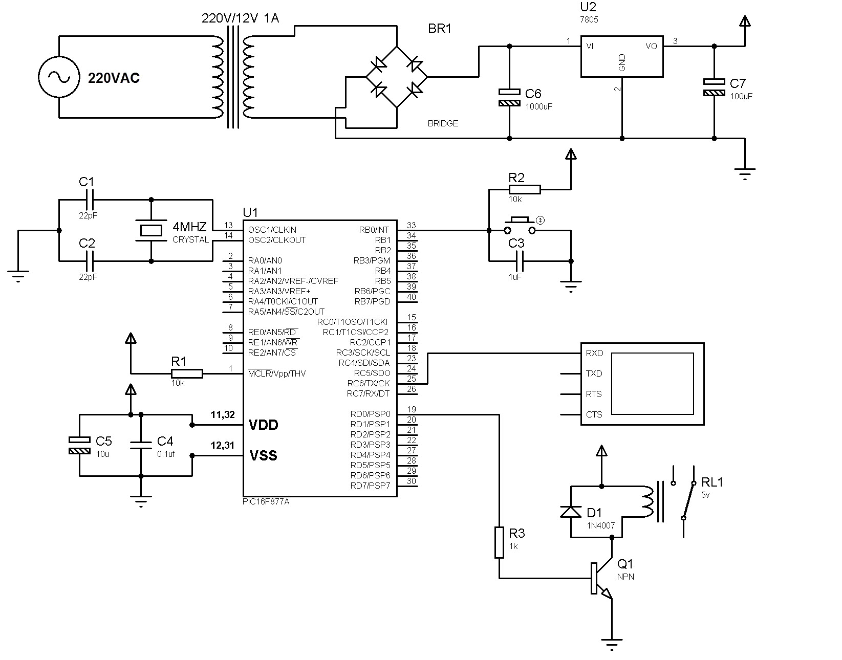

Here is the code and full schematic

I wonder if this issue could be caused because you are not debouncing your pushbutton. Write code for that too. You can check if the lack of debouncing causing the issue by writing a main program that just waits a bit, and then raises automatically D0 on it's own (no pushbutton) and see if it still happens.
The 1N4007 as a flywheel diode may not be fast enough to properly limit the voltage spike from the relay coil; normal rectifiers are rather slow to turn on or off.
Try a signal diode like 1N4148 or 1N914 etc. or high-speed rectifier in place of that.
What is the relay? What is the transistor driving it?
Your hand-drawn circuit showed a 0.1 μF capacitor on each of pins 11 and 32, while the other diagram only shows one.
Does the circuit reset if you short out the transistor? Is the power supply able to run the relay?
Your bridge rectifier is shown connected backwards. It must be a drawing error because the circuit would blow up if that is how it is wired.
Well, other than the bridge rectifier problem that audioguru pointed out, the schematic looks OK to me. But still doesn't show HOW it's built.
A schematic assumes that all connections, particularly the multiple power and ground busses, are made with near zero resistance/impedance interconnects.
From your description of the circuit behavior, I suspect that isn't true in your implementation of the schematic. Are you by chance using a solderless breadboard?
You said that when you energize the relay, that the pic16f877a resets. I think that the current that the relay requires may be pulling the 5 Volt rail down below the point at which the f877 resets.
To prove this theory, try separating the power to the f877 from the relay as dknguyen suggested in post #15 above. Either a separate 5V source, or diode isolating the two. At the very least, make sure the relay has it's own 5V connection to C7.
Additionally, as alec_t said in post 10, check your grounding scheme. The microcontroller circuitry can share a common ground connection to C7. But the emitter of Q1 must have it's own path to C7.
