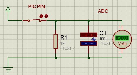

How exactly should i connect these?
I can see the voltage drop slowly in this sim. SO i have to count how long it takes to drop to 1.8v?

So would this be right? If i use 5v and a 10bit ADC then is 0v = 0x00 - 5v = 0x3FF... so 63% would be 644 (0x284)..
so i have to count how long it takes to for the result to reach 0x284 then divide it by the resistance used?
So lets say:
T = 100ms
R = 100k
So if I do
T/R = 0.000001 F
aka 1uF
Correct?
also to test this T=RC =
.000001 * 100000 = .1s (100ms)

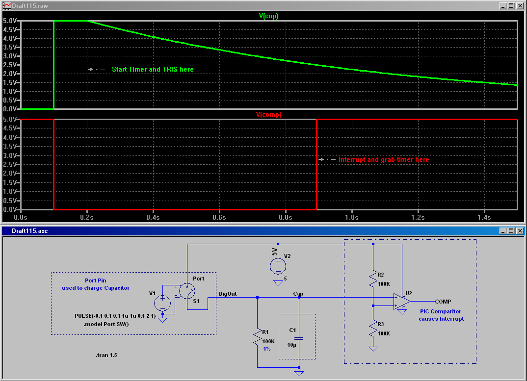

I see a couple of problems. I would use the comparator (not the ADC, which takes too long to measure the decaying voltage). Set the comparator to an internal reference of ~1/3Vcc to 1/2Vcc. Set the comparator to interrupt when the decaying voltage across the capacitor goes below the reference. In the ISR, grab the timer value that exists at that moment.
To charge the capacitor, use a port pin which is always set HIGH. To release the capacitor to begin discharging, set the TRIS for the port pin to INPUT. In other words, the port pin is either HIGH or OFF. Zero the timer concurrent with when the Port pin is switched.
It doesn't matter that the trip point of the comparator is exactly 1 time constant. You can just adjust for this in the math.
