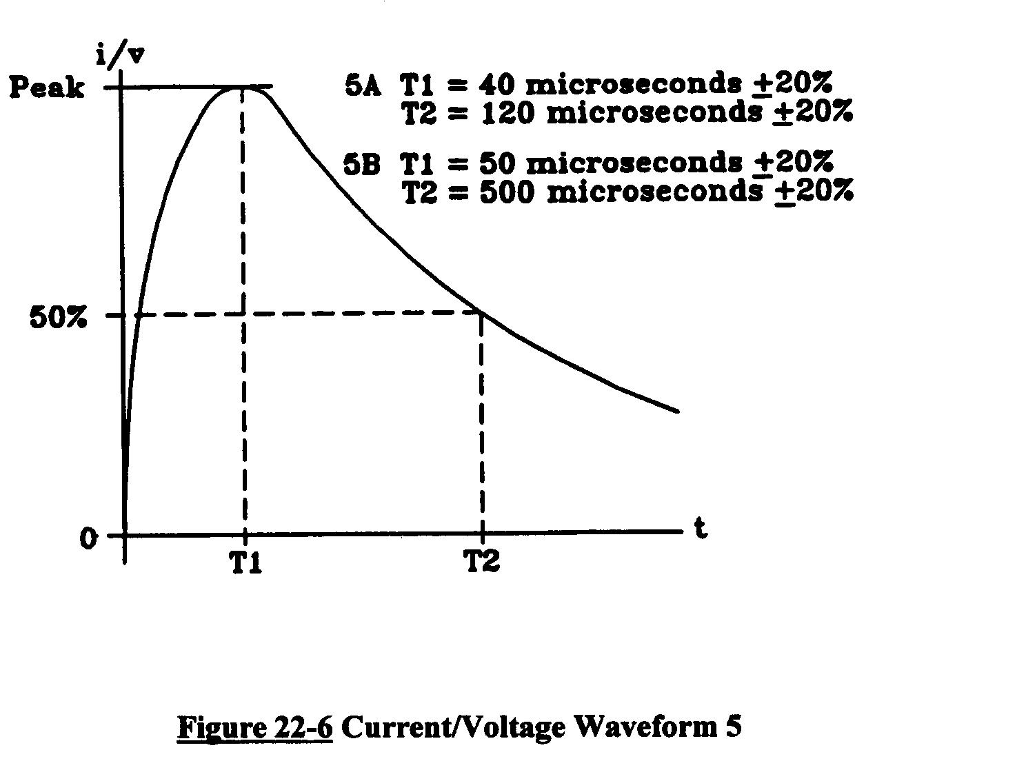

I forgot my formulas and could not remember how to do this so I need some input from everyone.
I would like to know how to measure the energy signal of the diagram below. I know that measure the signal energy is just measuring the area under the squared signal.
If I have a waveform that has the characteristics of
Voc/Isc = 1600/1600
Voc = Peak Open Circuit Voltage (volts)
Isc = Peak Short Circuit Current (amps)
How much energy in Joules.
