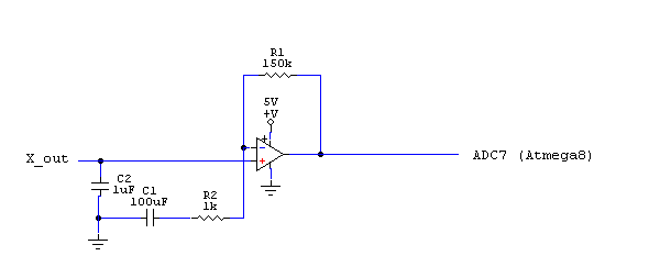

Is the real reason to use buffer (op amp) only for decrease output impedance?
Allright can anybody help me to solve this misterY..
I've found the op which should be good to go with accelerometer :rolleyes:
How do i know what's the main purpose of this OP?
I was thinking because of get lower the output impedance.

C2 should got value 0.33uF...
That was fast response.How did you figure out its 15..Need the formula..
What ive seen so far is Vs=Vout with Voltage follower and that's aLL.No resistors in voltage follower or capacitors
Its not x15.
At a frequency of about 1.5Hz, the 100uF capacitor starts looking like 1k Ohms. This is lower end of the bandwidth (At DC gain = 1, capacitor open)
When the input frequency >> greater than lower end, the capacitor looks like a short circuit compared ot the 1k and so the gain = 1 + (150k/1k) = 151 (not 15 !)
The gain will remain this until the opamp begins to run out of loop gain at some upper frequency (opamp dependent) then the gain will follow 20 dB/dec decrease.
Also BTW, the input 1uF to ground makes no sense to me. Its not part of any dynamics other than capacitively loading the previous stage.
Did you follow that? Gain for non inverting config = 1 + (Zf / Z1) where Zf = feedback impedance (just 150k this case) and Z1 is the impedance of the series combo 100uF and 1k.
And yes buffering with a gain stage (x1 or otherwise) also has the benfit of a lower driving impedance.
Its not x15.
Sorry, I read the feedback resistor as 15K :eek:

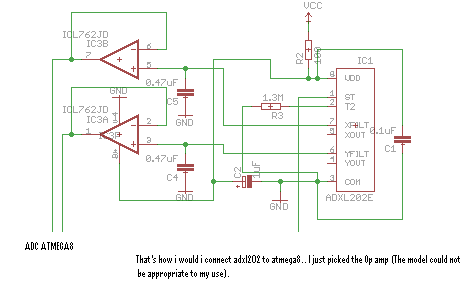

Here i am again...
I drew the scheme.My calculation and datasheet proofed the output of X_FILT and Y_FIL will be the 300mV/g...My purpose is to measure the tilt..If i tilt the sensor 90 degrees,the change is 300mv...Voltage VCC is 5V...
The 0g offset 5V/2 = 2.5V +/-300mV... 300mV when i tilt the sensor 90degree.It's maximum in my project.
What does the supply voltage in OP amp?Only comparation right?
What if i need the Amplification about 5 -> so 2.5V +/-1,5V?
Would be that enough?Are there some calculation of ADC at atmega8?
I want to get a til 1 degree at least..
Which Op amp do you suggest?What else should i consider next?
got a lot of questions i know :)

I can't find a datasheet for ICL762JD.
Why don't you use the duty cycle modulated outputs of the ADXL202?
I said PWM no..I want to explore area of the OP's and the ADC on atmega.Got some tutorials how to do it though..
The only reason to use ICL762JD was to "get a picture" ,it's voltage follower...I havent looked for the right one which fit to my use..
I'm calculating now, the resolution declines after 45 degree..I really have to put the buffer amplifier with the gain about 5...
