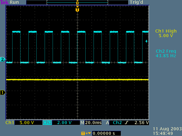

The output from the pc fan is basically the open collector output of a hall effect sensor. So its frequency varies with the speed of the fan. The problem is that you cant vary the speed too much because the sensor shares its power with the fan. I think when I was experimenting, once you get below 8V or so (I don't remember exactly), the output stops working.
On other motors it is wound like a generator so you get increasing voltage and frequency from the tach output of the motor. In this case, somewhere on these forums I put a circuit and traces from a 311 comparator/hysteresis circuit to "square-up" and clean the incoming tach signal.
Here is a picture of what the output of a pc fan captured on my scope.

The Fan on my compaq is a tacho for sure...
Could just be compaq doing it diffirent from the rest of the world :)..
nm my post then.
