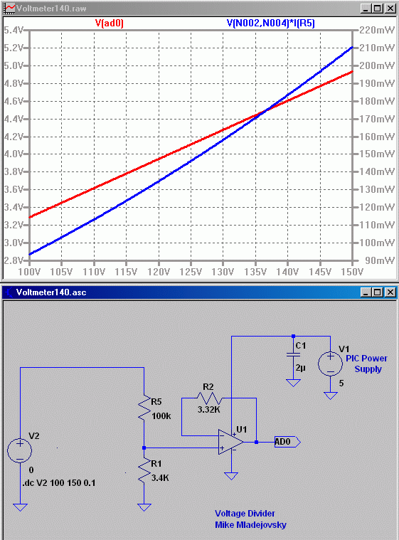

Hi All, i am currently using a voltage divider to bring the voltage down from 140V DC to +5V on the pin of RA0 in a pic micro. My resistors are getting very hot (100W resistors). Is there perhaps another way of measuring 140V DC on a the pin of the micro?
What are the resistor values?
Use a high resistance voltage divider then use an opamp follower to buffer it to an impedance the PIC A2D likes (around 2k load on opamp output).

Like this:
OpAmp has to be capable of pulling its output pin close to 5V rail. You must use a "rail-to-rail" OpAmp.
The only one that counts is the 100K. Look at the blue trace on my plot:D

Make R2, 3k3, a standard value.
47K R1 and 1K for R2
If those really are 100W rated resistors (wow!) then you have something wired incorrectly.
