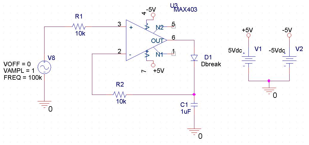

After some PSpice simulation I have come up with the following circuit that seams to work.
The only thing is that it only works accuratly for frequencie less then ~50kHz.
The output is the voltage across C1.
Which part of the circuit is the limiting factor?
Should the capacitor ba bigger or smaller?
Is there a good way to use a digital signal to short th output to ground?
Tried using a 2N2222A but it made the output fluctuate.
Would a mosfet be a better choice.
The circuit is part of a function generator. I am trying to measrue the waveform frequency and amplitude
for display on a character LCD. So the circuit needs to be able to be read by the A2D of a PIC 16F876A.

The limiting factor in the circuit for frequency response is the capacitor
If you reduce the value of capacitor the input frequency can be increased
its better to put a current limiting resistor in the place of diode as this will be fed to the microcontroller input.
There is also a IC available for peak detection with reset and hold mode
Check the analog devices website for IC PKD01
