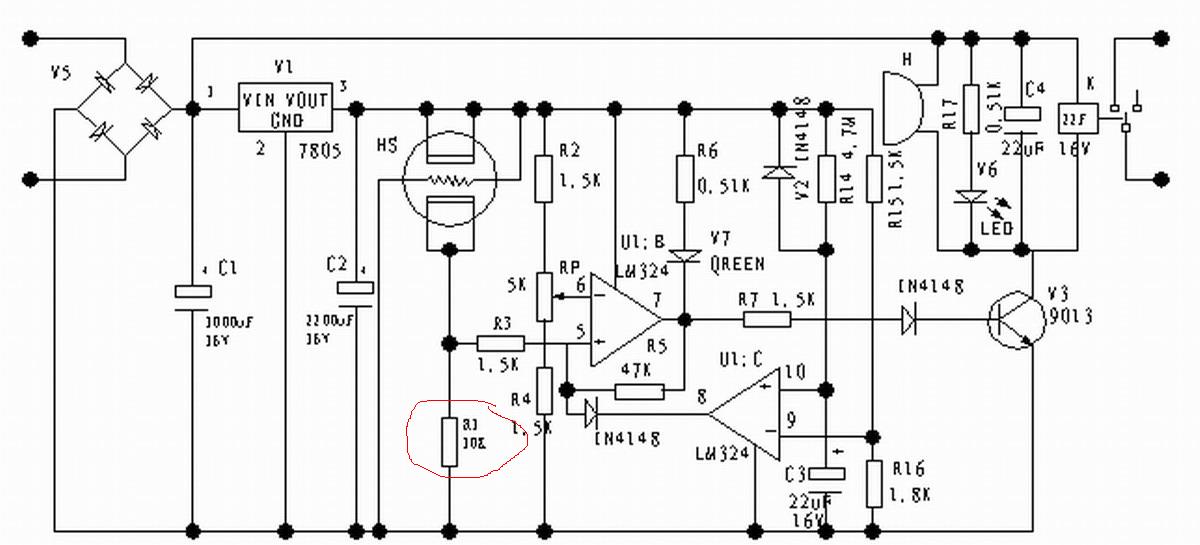

Hi, first look at basic test circuit of MQ137 that i attached you (JPG file). We have this formula in the datasheet:
Rs=((Vc/VRL)-1) × RL
Rs= Resistance of the sensor
Vc= +5 volt
VH= +5 volt
my application is alarming when NH3 concentration reaches or wants to go higher than 25ppm.
So i can measure the VRL value(voltage) and put this value in the formula to find the Rs value.
1- What value of RL are you suggest for my application?
2-What's the value of the Rs in 25ppm NH3?
3- The Rs value and the gas concentration in ppm have the inverse ratio or direct ratio? ( i think it's inverse ratio)
If i have RL value and measuring the VRL, i will put these values in the formula and find the Rs value.
If i have Rs value in 25ppm NH3(standars vaule of Rs for MQ137 in 25ppm that you will tell me), i compare the Rs value from the formula ( result of the formula) with the Rs value in 25ppm NH3 (the standard value that you will tell) and when they are equal or when the measured value lower than the standard value(that you will tell) i will turn on the alarm because when thay are equal or the measured value is lower than the standard value( that you will tell me) the gas concentartion is 25ppm or more than 25 ppm.(beacuse i think they have inverse ratio, if they have direct ratio, when the two value Rs reaches to each other or the measured value wants to go haigher than the standard value i will turn on the aralm)
I think it's the best way to alarm when gas concentration reaches or wants to go higher than 25 ppm.
please answer those three questions.

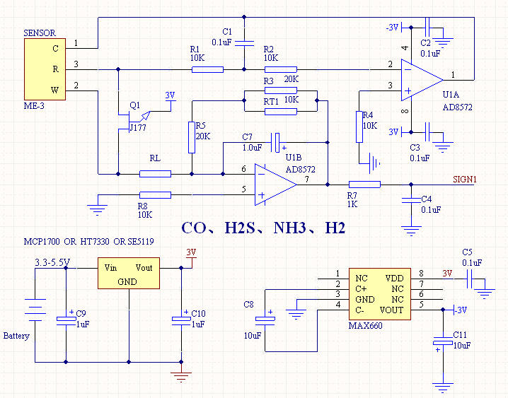

i want to make an intelligent monitoring system for aviculture that measure temperature,humidity and ammonia concentration and depends on the situations it turning on the fans,heater and etc. this system should alarm when ammonia concentration reaches or wants to go higher than 25ppm. i wanted to use MQ137 but it's difficult for me to calibrate the sensor because i don't have a chamber test or experimental environment so i think i should use ME3-NH3 because there is a linear relashionship between NH3 concentartion and output current and i don't need to calibrate it in a chamber test or experimental envirnoment.Am i thinking right?
the datasheet is not complete,it has no explain about the pins.
i have this application circuit(attached file),could you explain more about the circuit and how does it work? what's the output of this circuit(SING1)? i want to connect this sensor to PIC microcontrollers.could you explain about response time?
