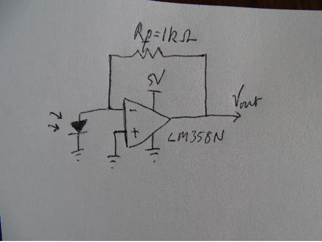

I am trying to measure the output current from a couple of PV cells I have. However, I am not getting the expected output.

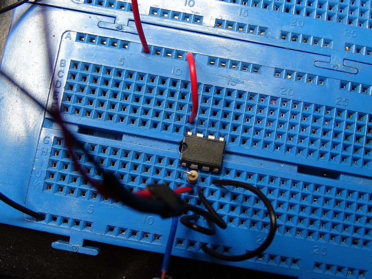

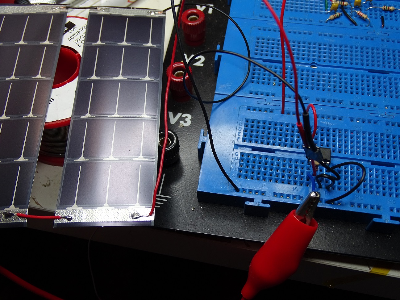

I have constructed the following circuit:
My understanding is that Vout = -IR. I then constructed the circuit as follows:
Overview:
Detail:
I measured the output current to be -4mA, so with the 1k resistor, I would expect the output voltage to be around 4V. However, it comes to only 0.8V. Moving the light closer increases the output as expected, and moving the light source away decreases the output too. However, it does not seem to reflect what I would expect. I tried using a larger resistor value, expecting the output to increase, but if anything I found the output to be _inversely_ proportional to R, which is not right at all...

Your measurement setup is attempting to measure the "short-circuit" current of the PV cell (into zero V imposed by the virtual ground of the opamp) . You can do that by just connecting a millampmeter directly across the PV. This is not a useful measurement, because a PV delivers zero power into a dead short.
Characterizing an unknown PV is all about finding at what combination of load Voltage and load Current the maximum Power out of the PV is achieved (called MPPT). Connect the PV to a variable resistor (with sufficient power rating). Vary the load Resistance. Measure I and V, and find the R at which I*V is maximum. That is where you want to operate the PV.
Here is a simulation of the process: Note that for this particular panel, the optimum load resistance is 152 Ohms, where the panel delivers ~3.5V @ 22mA. You can also see that the open-circuit voltage is ~6.5V, and the short-circuit current is ~45mA.
You could use a current meter to measure the current. I know the voltage will not be zero but close.
You are using a solar panel, not a photo-diode and you show it connected backwards on your schematic. The cathode of a solar device needs to feed the (-) input of the opamp for the output of the opamp to go positive.
When the output voltage from the opamp goes as high as its power supply voltage allows and the light intensity increases then the input voltage of the opamp might exceed its -0.3V maximum allowed input voltage with no negative supply.
A solar panel produces a voltage or a power but you are trying to measure only its short-circuit current that is not useful. A photo-diode is used as a light sensor when it feeds its short-circuit current with the correct polarity into an opamp (-) input.

Other issues with your I-V converter are:
The transfer function is -I*Rf
Usually a capacitor is placed across the feedback resistor for a number of reasons.
The real transfer function is Vb-I*RF where Vb is the voltage at the + input of the OP amp.
The OP amp HAS to be able to supply the same current as the solar cell so the currents can sum to zero.
A single supply circuit is tricky because, in practice, you can't achieve zero volts. The offset voltage of the OP amp gets you every time.

From looking at your photo, my estimate is, you have two (2) x 5-cell silicon PV with each cell being approx 1 sq in. with a hardwired array of 2P5S.
