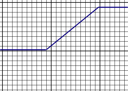

Right take this waveform for instance.
say 1 sqaure = 1V and 1us
it is approxamitly 9 spaces high (remember engineering is knowing when to say PI =3.14)
this is for 0% to 100%
It is equally 10.5 devisions in the X-dimentions
Since maximum voltage (ie 100% is 9devisions), so 10% = 0.9V.
This occurs 1 time devision from the start of the slope = 1us
eqaully 90% = 8.1V
and that occurs 9.5 time time devisions from the start = 9.5us
thus the rise time for 10%-90% = 9.5us - 1us = 8.5us rise time
follow that

Time intervals are taken from the scope division setting, ie 1us/Div for instance
From that you know what 1 big square on the scope is worth.
why would you want to know what 20%, 30% is when you wanted "rise-time" which is defined as the time taken for a signal to change it voltage form 10% to 90% of its full voltage swing
As Nigel stated this is simple maths
What is 10% of 88 for instance?
What is 40% 49 for instance
what is 90% of 3.1415926 for instance
in this case what is 10% of 9
what is 90% of 9
at what time (from the start of the rise) does a voltage of 10% occur
at what time (from the start of the rise) does a voltage of 90% occur
What is the difference between those two time? = rise time

All scopes have an uncalibrated variable gain knob. Adjust that knob until the pulse waveform spans exactly 5 divisions vertically. Set both pulse levels on graticule lines. When the pulse rising edge is exactly 0.5 divisions above the lower level, that's 10% of the amplitude. Note the position of that point on the horizontal (time) scale. When the pulse edge is exactly 0.5 divisions below the upper level, that's 90%. Note that position on the horizontal scale. Now subtract the 10% time reading from the 90% time reading. The result is the 10-90% risetime. For falltime, do the same thing on the falling edge.

Decent scopes (i.e., "real" analog scopes made by Tektronix) have had risetime graticules since around 1965 or 1970 if the scope had a bandwidth of around 35MHz or more. If you look carefully at the graticule, you'll see the major division lines and then two dotted lines. You use your volts/div knob and your variable volts/div knob to adjust the pulse waveform screen height so that the more positive level is on the upper dotted line and the less positive level is on the lower dotted line. The next major graticule line above the lower dotted line is the 10% point. The next major graticule line below the upper dotted line is the 90% point. Speed the time/div up so that the transition uon which you are triggering is spread out as far horizontally as you can get it WITH THE VARIABLE TIME/DIV IN THE CALIBRATED POSITION, adjust the horizontal position so that the 10% point crosses over the second vertical major graticule line and measure the time (number of divisions multiplied by the time/div setting) between this point and the point where the transition crosses the 90% point. This is your risetime.
Note that the oscilloscope your are using must have a faster risetime that the transition which you are measuring or all you'll be measuring is the scope's risetime.
If you have the trigger slope set for "+", you'll be measuring the risetime. If you have the trigger slope set for "-", you'll be measuring fall time (from the 990% point down to the 10% point).
