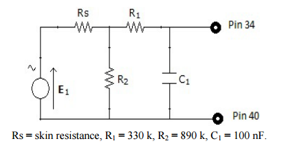

I am trying to measure the skin conductance, for that I found this circuit online.
upload_2015-11-5_3-5-39-png.94053
So from it what I have understood so far:
- There is a low pass active filter at first stage with cut off of 1.6 Hz and variable gain.
- The second stage is also a filter with unity gain and is biased at half the voltage supply and the first stage is biased at the output of second.
What I don't understand:
- Why is the gain variable at first stage as the Rskin changes the gain would change?
- Isn't the first stage enough?
- Can't understand the biasing of the op-amps as well.
The Biasing looks correct for an LM358, Single Supply op-amp.
Yes, the pot will change the gain.
Skin conductivity will also change, Depending on your Skin type, Moisture Content and Size of the Contact Area.
Without actually building it, I can't say How good this circuit is!
This is a classic inverting gain design with negative DC feedback on the (+) input. so that the galvanic skin response is neutralized.

chemelec what could be the problems with making a simple voltage divider followed by a low pass filter like this one
When you say "skin conductance", Do you mean: Human Skin?
E1, Sine Wave?
What Frequency?
What is the device that has Pin 34 and Pin 40?
chemelec Yes, I mean the electrodermal activity that is the change in the conductance of the human skin due to the presence of sweat for instance or any sort of emotional arousal.
Let's assume E1 to be DC, 3V for instance.
Pin 34 and 40 are nothing it just shows the points where I'll be taking the output.
