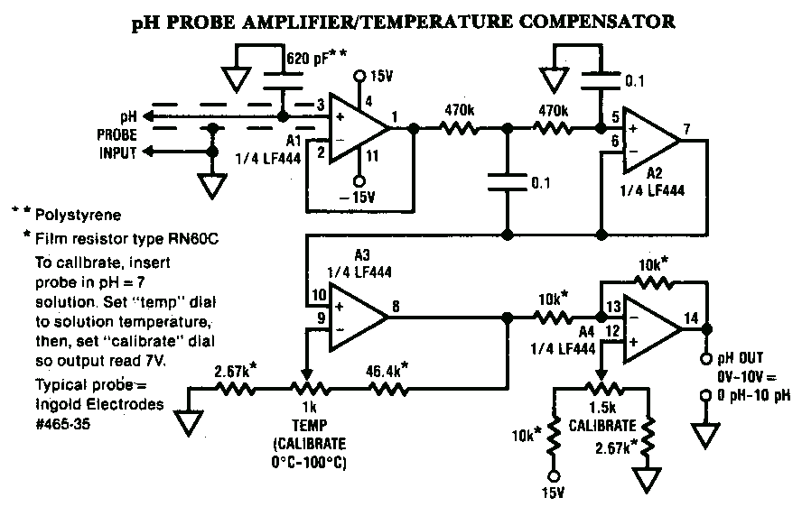

thanks klaus! but my problem is how to create a PH circuit?? ive been searching at google and all it gave me is a commercial PH test.. do u have a circuit in mind that u would like to share?? i would gladly appreciate it. :D

Here is a Circuit to start with. You would have to build a circuit that turns on the pump when the Ph is too high.
Check these out as well.
