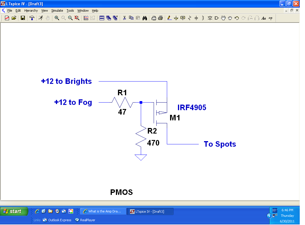

I am a noob when it comes to electronics. And I've joined this forum in the hope of getting some practical advice to realise me theoretical visions. I'm going to post a few projects here, some of which may never be built, others which I am hoping, no, going to build.
My first project may never be built (for non-electronic reasons), but I'm still hoping to extract some useful info from this for future projects.
Here's the scenario:
My car has four headlights: two driving/dipped lights, and two foglights. The lights are powered by the main switch, which also turns on the front fog lights and then the rear foglights (but I'm going to ignore the rears). The column switch activates the driving lights when pushed forward, which turns off the dipped beams. Pulling back on the column swich also turns on the driving lights, but only to flash - a spring returns the switch to centre (i.e. dipped beams). The first schematic is my approximation of how this works. I have omitted the main switch, since that is assumed to be always on for the purpose of this project. The flash switch is included, though.
In South Africa we seldom have use for the foglights, so I was thinking about converting the fogs to spotlights instead, and connecting them to the driving lights. Then I had a brainwave: Why not convert them to fog/spot combination? The main lights use H4 bulbs, so too could the fog/spot combo. Now I would need some logic to prevent the spots being on at the same time as fogs (except, maybe, when flashing), since driving conditions usually render the two mutually exclusive. I don't really want to modify the switches of my car, but maybe I could use a transistor to switch off the spots when the fogs are on, or to let the spots be switched on by the driving lights when the fogs are off.
The second circuit is an approximation of this setup. I have also included what I believe to be a "truth table" of this setup. So first question: could this actually work?

Even if I use relays to power the light bulbs dircetly, the transistor as a switch will only be required to actually allow this or that relay to switch on. My question remains:
1. Fundamentally speaking, could this work? Forget about specifics - this or that type of transistor, power capacities etc. Could I use simple transistor logic to control which beams to be lit up mutually exclusively?
2. Fundamentally speaking, which direction of which configuration of transistor should I use? NPN, PNP?, Common emittor, common collector, common base?

Lights
From your drawing it doesn't look like the flash is correct - no flash if dims are on.
But that's not relevant.
Here is a circuit that should do it.
It may need a bit of a heat sink.
Basically spots are on if brights are on and fog switch is off.
Be careful of the current in both the wires and the switches.
Oops, better make the 470 ohm resistor 1000 ohms - a bit to hot.
