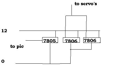

If i get you,
You want to do this trick :D
You want to load the capp and the power it unloads can only be wasted/usted bij the 7805?
So in my case i also use some servo's, they are connected to 7806's
(2 in parallel with heatsink)
soow i noot to connect them behind the diode 2..
the sheme is like it is now...
Hope you can help a bit
TKS
Sheme

It depends if the servos will discharge the large capacitor, you might need to feed just the 7805 from the capacitor.
