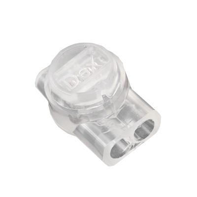

I never suggested a jack, I suggested the correct IDC connector box to join Ethernet cable together, far better, neater and more reliable than those horrible single 'bean' things :D

Those horrible single 'bean' things are insulation-piercing contacts which is also known as IDC
There what the phone company use for horrible little wires like the OP wants to connect but can't solder.

WIRE CONNECTORS - UR IDC BUTTSPLICE 19-26 AWG - RED - 3 WIRE - GEL FILLED​
Make wire splicing simple with these handy IDC buttsplice connectors. Self-stripping, insulated and moisture resistant, these buttsplice connectors are ideal for telephone wires. Simply insert both wires and snap the connector shut. The connectors are gel-filled to provide moisture resistance.
Features:
  • 19-26 AWG
  • Color: Red
  • 2- or 3-wire
  • Self-stripping
  • Gel-filled
  • Solid Conductors Only
  • Insulated and moisture resistant
  • Ideal for sensor and polarity wires
That's red ones yellow are for smaller wire

No, they are crimped. you insert the wire into a small bore piece of metal tube and squeeze the metal to form the connection.
I'd also recommend the gel splices that be80be posted. Make sure they are the gel/grease filled ones, a dry version is also available but that has no corrosion resistance, which is absolutely essential with mixed metals such as the CCA cable.
Just push the two wires all the way in, then squeeze the thing with a pair of pliers until the "button" is flush, to force the IDC contacts to engage with the wires.
There are many makes, search "Telecoms gel IDC splice" for various types.
eg.
