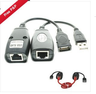

Now have been using an Arduino Uno sending the data out via the Serial Monitor using a 15mts Cat 5 cable and a usb to rj45 adapter on each end.
However this still gives the same kind of error using the Arduino serial monitor or fed straight into Putty.

Assume my Cat5 Cable and RJ45 to USB Adapters should work ok at that distance; only used in a domestic environment ?
( my desktop PC is a totally different machine to the one I had when I tried the Pic18 so think I can eliminate that )
I'm using a pair of these adapters on either end of the Cat5 cable.

There's a nice simple test to do here :D
Connect a PC at both ends, and see if it works reliably like that - assuming it does?, then you can start looking at the PIC side.
One point, how much power do the converters take?, and can the PIC circuit provide it? - if it was marginal it might cause intermittent problems.
While I don't like to keep pushing the same solution all the time, how about a pair of HC-12 RF modules instead of the wire?.
