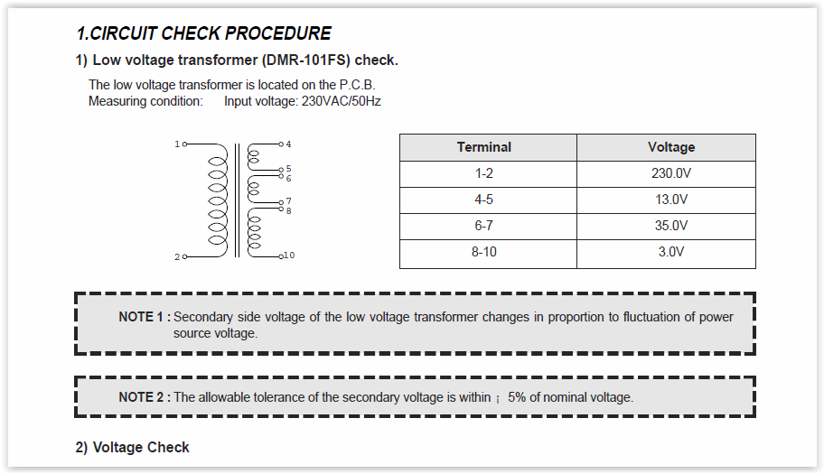

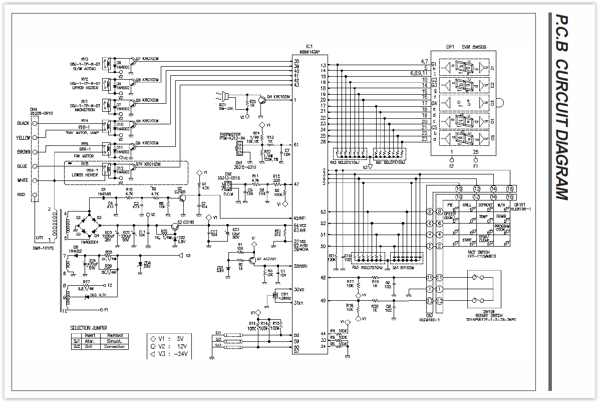

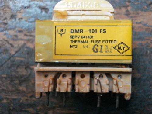

Daewoo no longer supply this transformer.............am trying to find a solution.
It is the L.V. transformer.
Info and photos, and service manual :
I have established :
DMR-101FS, 5EPV041351, SEGI 98.J26 A
Terminal 1-2 230 VAC /50Hz
Terminal 4-5 13.0 VA C
Terminal 6-7 35.0 VA C
Terminal 8-10 3.0 VA C
but this is not clear to me................on terminal 4-5 ...........is 13.0 VAC the watts (volts x amps) or the voltage AC ?
I came across this webpage looking for a replacement transformer:
https://articulo.mercadolibre.com.a...rmador-para-placa-de-microonda-dmr-101-fs-_JM
but I am not prepared to pay 150 dollars for a second hand transformer, and it does not seem to correspond exactly anyway ??
Please refer to attached photos.
Many thanks for any help or ideas you may have to offer.
