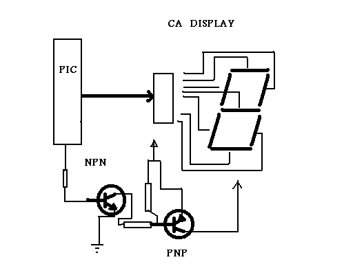

You say you are having problems with the display. The sheet you attached says that it is using common cathode 7-segment displays. Are you using CC's, which recieve the active high data on individual anodes, or are you erroneously using common anode displays which are expecting active low data on the cathodes?
Another thing is that they are using PNP transistors with the collector (diagonal without the arrow) grounded. Code lines 00091 through 00095 confirm that they want a PNP, because the single 0's they have bringing the base (straight line) low activates the connection to ground. I find their use of PNPs peculiar, as I have only used a PNP with the emitter (arrowed line) connected to supply voltage. The collector then powers anything connected to it whenever the base input drops below the emitter voltage. With NPN's, however, I connect the emitters to ground. The collector provides a sink to whatever is connected to it when the base voltage rises above the emitter. Those are the only two configurations I have ever used. When I look at their diagram with the PNPs emitter connected to the common cathode of the LEDs, I have to wonder what condition would cause the transistor to activate? I can only assume: When the base voltage drops below whatever random signal is momentarily present on the LEDs, it shorts the grounded collector "up" to the emitter, providing a sink for the display. I don't like that. It may be perfectly acceptable, or maybe they just had some PNPs laying around. I don't know. But if I was designing the circut, I would put NPN transistors in place, ground the emitters, connect the collectors to the common cathodes, and change lines 00091 to 00095 of the code to reflect that change:

That would cause the 1's there to "turn on" the ground to the collector, and provide a sink to the 7-seg cathode.

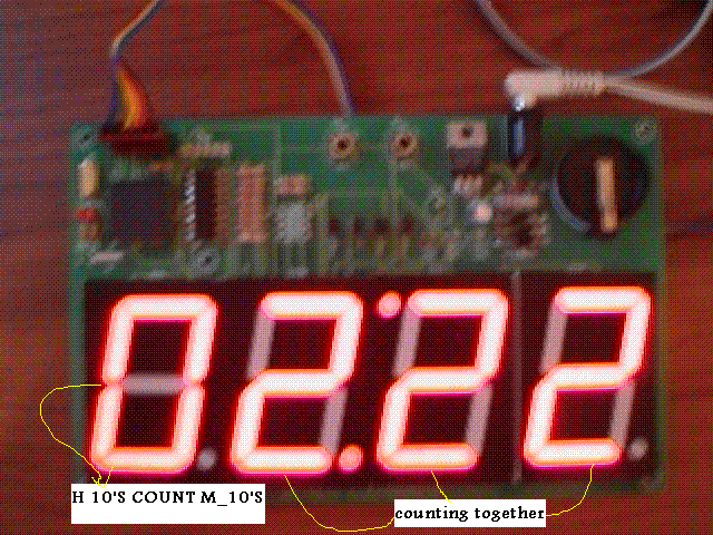

first of all the display lights up no problem the digits can be drived on by one i did a test code on them they are fine.
i am using a CA 7-segments .(look at the drive.gif) .oh and the IC between the PIC and the disply is a ULN2003 (7 NPN's)
the errors are
1. the display should startup at 12:00 it starts at 00:00
2. from R to L the first 3 digits count together MINUTS
3. the forth digit count 10's MINUTS
iam not worried for know about the function off the switches iam trying to get the display correct.

hi
just an update ................you are right i did not pay attention to the transistors they are PNP and now the clock works fine and the display
is fine .
and the maze is the display will not show the correct numbers if i use NPN transistors even if i change the disply BITS in the code.
isnt against electricty rules to use PNP on the CC of a disply or they are using this TRICK so the PNP leaks to the display not to sink!!!!!!!!!!!!!!!
NOW i have to find a diffrent way to drive my CA displys and make the code work for them.
hi did 'not hear from you
the code is working fine with the CC displays and PIC16C54 on the
proto_ board...BUT not with my big CA displays and 16F877 .
iam posting my code can you please take a look and kind direct me in the right way to fix it,
the big CA diplay's as its wired working fine i did some test codes and i can display scaned numbers on it with no problem.

i agree with you on the sigments change ...but that will work if the cathod
sigments conected directly to PORTD.
in my case if you look at DRIVE.GIF i have a ULN2003 driving the sigments.
witch mean i need a 1 at the inputs to have a (0) at the output thats why i left the sigments decoding the same way.
