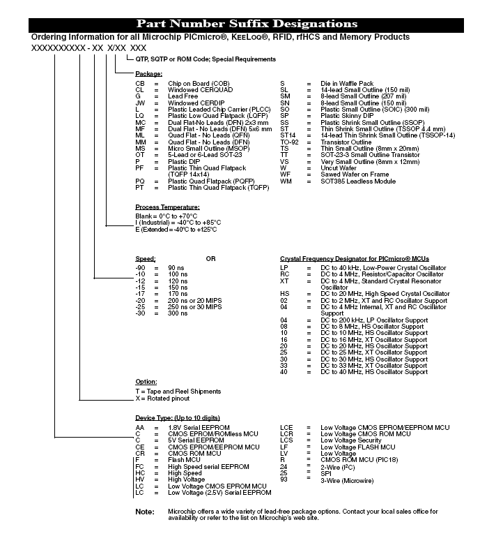

Microchip descriptions
I'm confused about the names, which the PICmicro chips have.
What does they mean, e.g.
I/SP
04/SP
04/SO
/JW
04I/P
04I/L
/L
/P
I/PT
- or does it matter which type of programmer I should use?
Are there some kind of survey of all descriptions?
Electronics4you
As always, everything is in the datasheet!
There is also a summary in a document called **broken link removed**, page 121 (123 in PDF).
