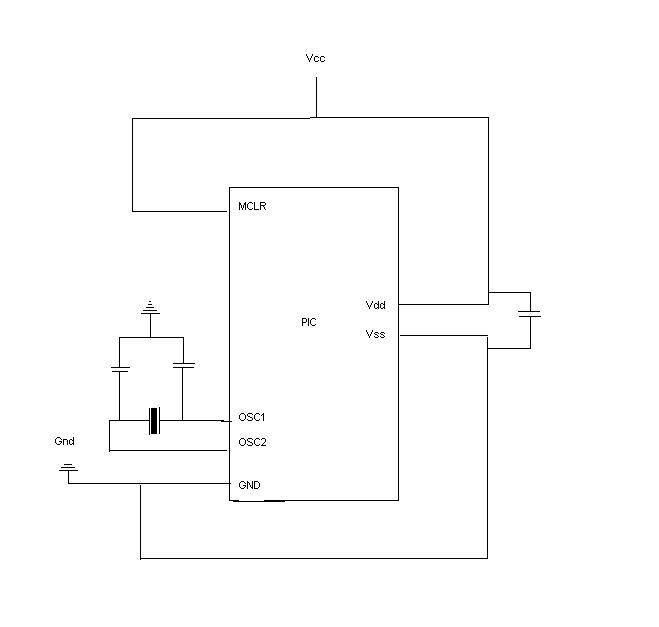

The microcontroller works fine when i debug it in my development board using ICD but it doesn't work when i plug it into my own circuit.... Maybe's its coz of a faulty cap or something.. how do i check
Can anyone give a schematic just required to run the PIC Mcu.. is it same for all of them? Also what should be the values of the capacitors used in the circuit.. do they matter?

Post your schematic.
Heres what i am doin
I assume you program it out of circuit as MCLR is tied to power.
Which dsPIC is it, is the powersupply well regulated and filtered?
Post the pinnumbers too.

Please understand. you are telling general things. till now you have not indicated any Chip number. For any dsPIC there is a datasheet that fully describes how to use it. i suggest that you may download the concerned datasheet and have a detailed study.
Meantime try to put the hardware schematic that you are using for your design -- also please indicate whether you have a PCB layout or used a general purpose Board-- or a breadboard. because thease issues do matter. clocke oscillation methodology is important subject matter and Microchip themselves have published specific articles and dedicated subsections for each chip in their datasheets.
for example , breadboarded circuit would behave erratic at these frequencied -perhaps same may be the case with dsPIC.

When you tried to run without the ICD attached, did you program it with the Programmer or Debugger tab? The Debug tab will load the Debug Executive and you can't run it without an ICD attached.
You MUST install a resistor between MCLR and Vdd. I don't know how you programmed without it.
If it's the 33F be sure you have the specified VddCore cap.
