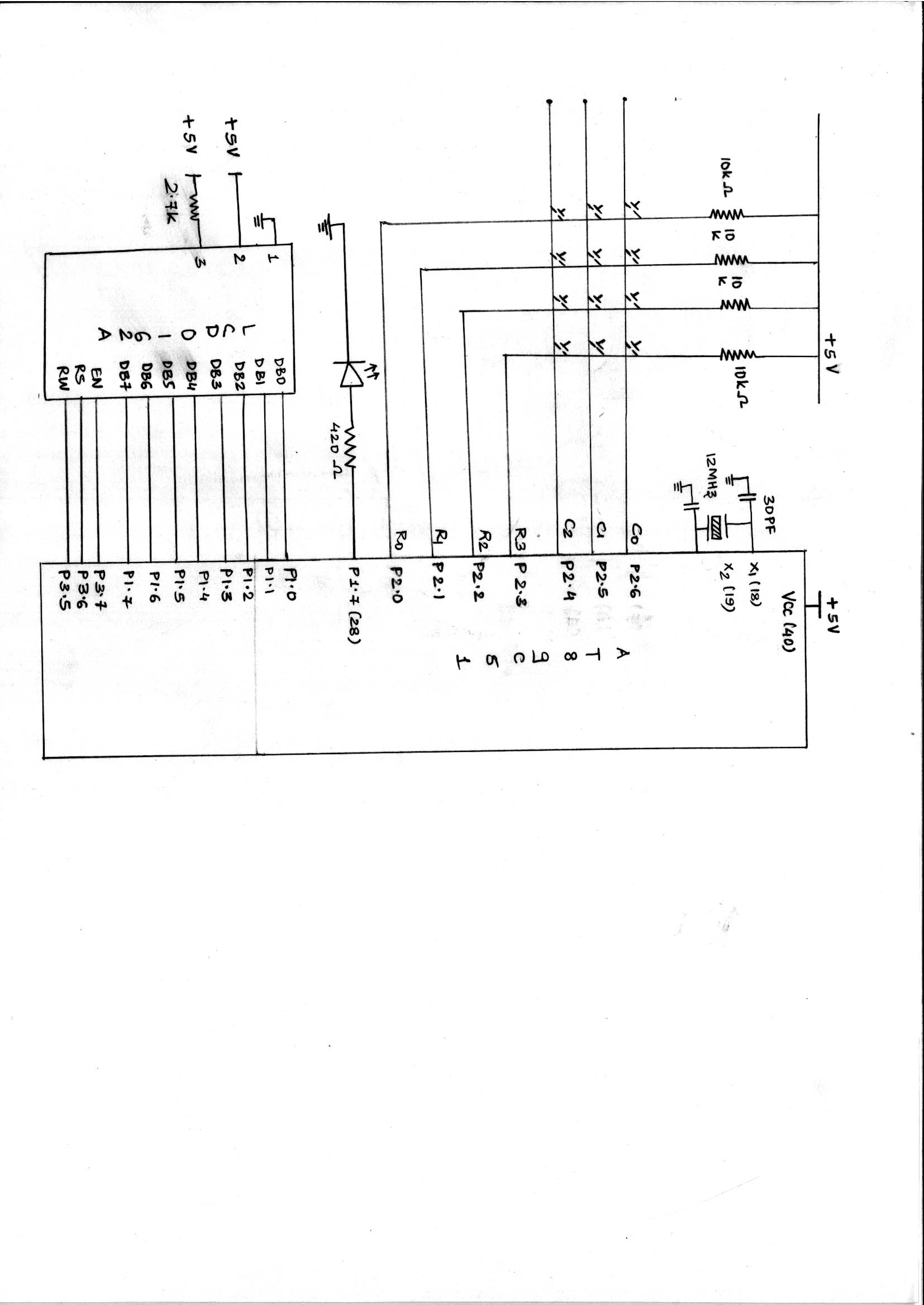

i am having mp project of position control of stepper motor
motor used is M42SP-5(12 V 269mA 345pps),
DRIVER USED IS ULN2803
i will be inputing no of steps n half steps through matrix key board n using lcd display to show the angle(my plan!)
now i am having problem with writing code i am using 89c51 to control.
How to calculate delay to be given to motor, how it should be given and if i want to do half steppin how to do it.(i just have general idea about in which sequence phases of motor should be activated)
Also tell me how the code should be written and before putting in 4 application how i can check if i dont have any logical problem with code?
please help me :p

i still have few doubts
1. if i am using 15v,1A Xmer folloed by 7805 and 7812 regulator ic do i need to connect current booster transister?(from same Xmer i am giving secondary to bith ic's)
2.i am sending the program . I am expecting this program rufly to first ask for password then take no of step from user then move by that angle and then if user wants to go back then go back to original position . assembler i am using is mide-51
it will be great if can go through the program and tell me if there are any problems as soon as possible as u have the prctical experience what works better.
3. if u know what are denger signs that we students are most likely to make mistakes then let us know.
This means 15V and 1A is the max rating of the whole transformer and you can work in between that. Now you need to know how much current your 5V circuit is taking and how much 12V circuit is taking.
Here 12V will be for motor only. And on 5V you have LCD, just check for the current requirement.
You need good heat sink for both the regulators as they both will give more that 300mA current and there is a chance that both will heat up.
If you have written it for that purpose, then it will definately give you the same output. :lol:
Anyway compile and debug it and see whether it is performing it as expected.
Not only students but even masters can do mistake.
hello
thank u i attached heat sink to both the regulator ic
few questions
1. for motor m42sp-5 max pull out pulse rate is 365 pps and max pull in pulse rate is 375pps so i calculated (1/365)=2.74 ms to be the dalay given between to steps thus am using 4 ms delay is that ok?

hello
1. here is the partial ckt of lcd and matrix keyboard interface
Lcd used is JHD 162A of withich pin 15 and 16 i will be leaving open rest of connections are shown.
In matrix key board also interfacing is shown. So plz it will be grat if u go through it and tell me if any corrctions.
2.Corction in the motor circuit i have done. Now is that to activate motor i need to give active low signal? because i then tried 1110,1101,1011,0111 seqence with common given to +12V (here by 1=12V and 0=gnd) and that is rotating the motor properly.So is this the way things are to be done and when i operrate it through the motor driver will work same way?
3. To drow ckt i tried to use egal sofwere but found it thokugh to get desired components for lcd and motor. so what is the easy way to drow the ckt? I have mutisim but it doent allow me to drow such ckts using 40 pin ic
4.Troubling u onec again on delay, how to calculate delay for motor? :roll: the calculation i did was (1/ max pull in pulse rate)=2.74 ms and for safty if i am givig 10 ms delay now but i am not sure or else can u go through the data sheet attached and tell me properly? Should i use 65ms delay?
5.About program, the delay loop i have wriiten in program is not incrementing the timer count i.e. th0 and tl0. So wha might be the mistake? For your ref here is the loop again
DELAY:
CLR TR0
MOV TMOD,#01H
MOV TL0,#0f0H
MOV TH0,#0d0H
SETB TR0
HERE2: JNB TF0,HERE2
RET
6. regarding ckt i am using std reset ckt .
thank u
regards
prachi
