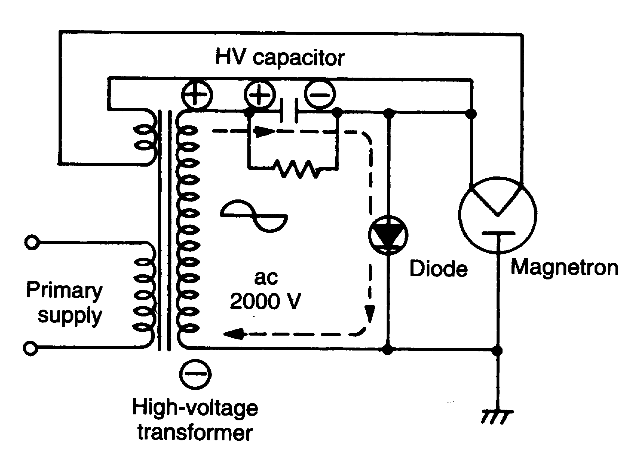

The transformer put out about 1.8 to 2kV. The rectifier was actually a voltage doubler, the feed to the magnetron was from across the diode so there was a peak DC supply of about 5kV.

The HT rectifier is a simple halfwave one, it's just that it's connected strangely - DC output is just under 3KV on load - using an old Avo8 on the 3000V range a microwave starts just off scale (but not bashing nastily on the end stop), and drops back to just below 3000V as the mag fires up. I've got an old Avo8 I use exclusively for that purpose.
The low voltage heater winding is very low, probably only a volt or two.

This is a typical oven circuit:

also be aware that there are two types of filter cap for the 5KV rail. one type has an internal 10meg bleeder resistor in it that discharges the cap within about 10-15 seconds. the other (older) type has NO bleeder resistor, and will hold a charge for quite some time. ALWAYS discharge the cap when working on the inside of the oven. i've fixed a few ovens in my day, as well as a lot of TV.s and computer monitors, and it's my habit to put a 'gator clip across the cap terminals or between a CRT anode cap and it's ground strap if the unit is going to spend any time on the shelf waiting for parts. i've been bit by caps and CRTs that had been previously discharged and subsequently recharged because of dielectric absorption.
