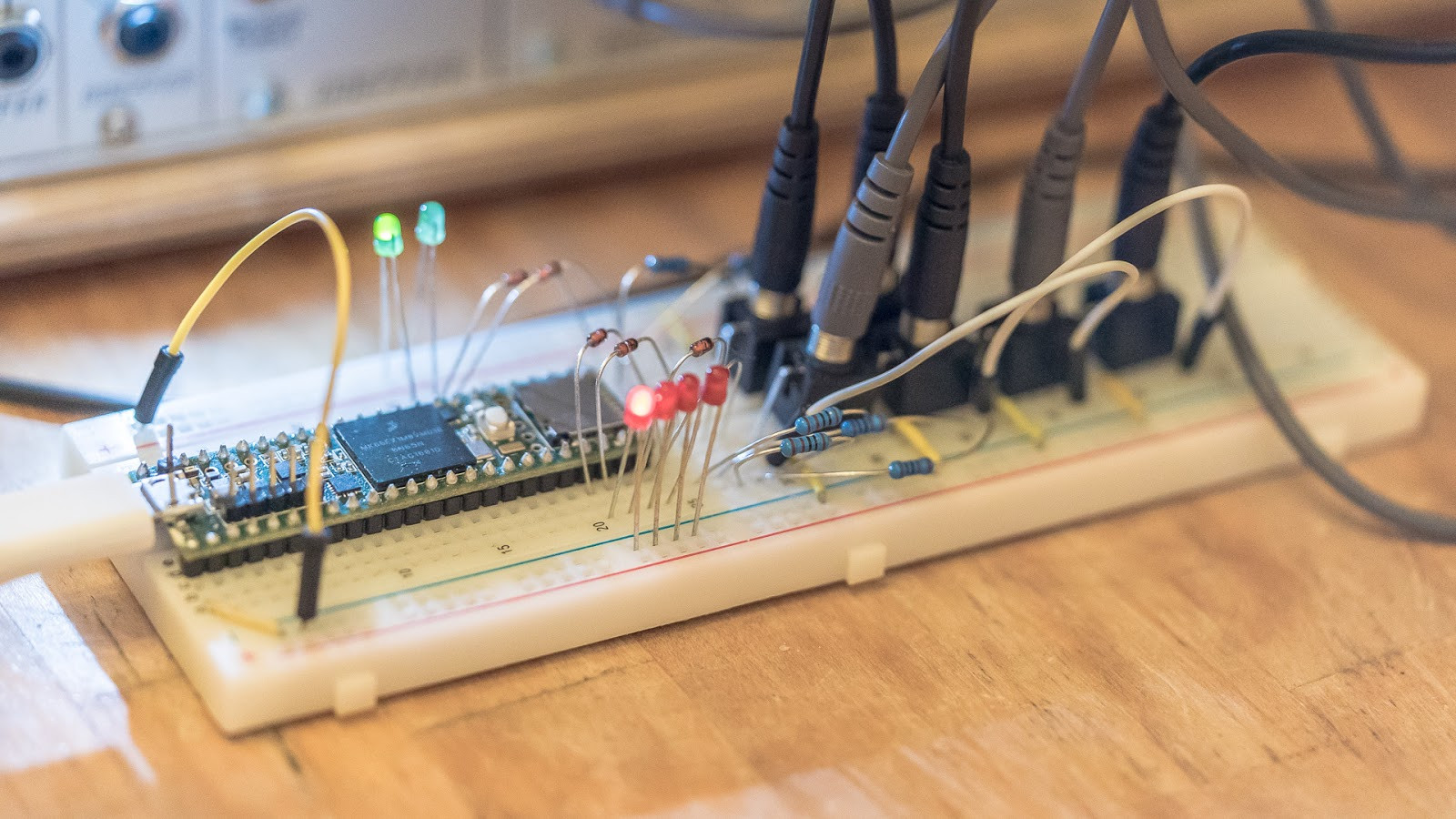

If you google for 'midi to cv', or 'arduino midi to cv' there are many examples, such as this one:
Or a PIC one:
