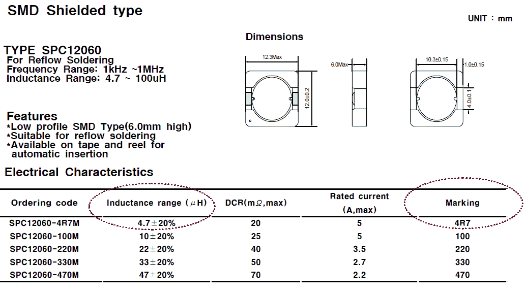

An assumption doesn't necessarily have to be the truth. Telling the R stands for a decimal point doesn't help much. Try to find an SMD-ferrite with an inductance of just 3.3µH. The size looks like it has to be 33µH.

This will, hopefully, remove one of the uncertainties.

What do you mean? Are you saying I made an assumption or you did? I made no assumption. Telling someone that the R is a decimal point is the truth. How does this not help. It is the standard convention for component numbering.
