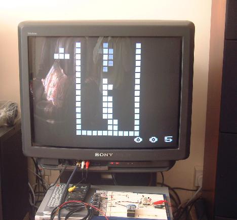

Oh, sweet memory of nearly three years ago!
Just rename the file tetris_F628A.txt into one with .HEX extension and load it into a F628A for it to work.
very nice eblc1388... but where's your joysticks? :D thanks for your help! (and the other guys too..)
