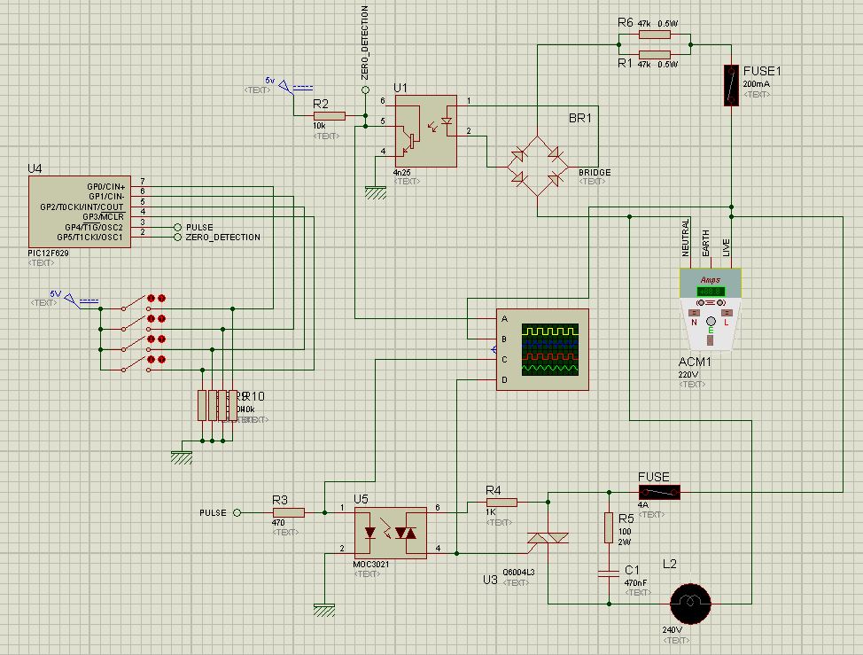

okay i have written the following code but its not properly working:
The problem is that i cannot read input from 4 switches connected at A0 - A3;
Also i cannot figure out how to use internal oscillator of PIC12F629 for 4MHz.

I don't use the CCS compiler as it uses strange syntax. I use the free version of BoostC.
As to your problem, I suspect you need to turn off the comparators with CMCON=7;
I know many are apprehensive about learning assembly, but your task is QUITE simple. It is worthwhile to learn 12F asm, and the instruction set is VERY short, so I'd say learn it.
This is the circuit i am using.
I cannot find out how to turn of Comparator in CCS :( Nothing mentioned in its help either.

That is why I don't use that compiler. In BoostC it is simply cmcon=7;
If you want to try converting to BoostC I can get you started.
