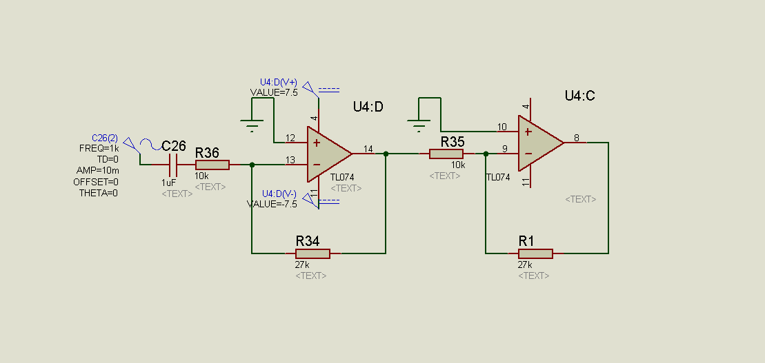

Hello guys,
What is the best choice to amplify the output signal of an electert or dynamic mike?
I my self designed the below circuit. Is it just right to do so? Is there any trim needed for the said circuit?
Thanks bunch.

An electret mike will need a bias supply.
You may need more gain for a dynamic mike.

Your input impedance is only 10k ohms which will load down and reduce the output from an electret mic. If the first opamp is non-inverting then it can have a higher input impedance of 100k ohms (and the input capacitor can be smaller).
Your gain is only 27/10 x 27/10= 7.29 but since it loads down the mic then the actual gain is less. It should be 50 to 200 from a single audio opamp like a TL071.
The opamp does not need a dual-polarity supply if it is biased correctly.

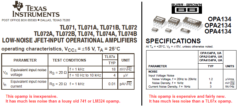

A TL074 is too noisy (hiss) for the extremely high gain you want. An OPA2134 (dual) or OPA4134 (quad) are much quieter.

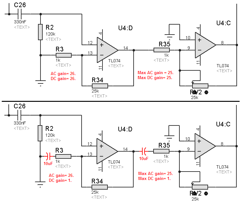

Your highpass filter cuts off at 4Hz so it passes voices down to about 40Hz and passes air conditioning noises and jet airplane noises down to 4Hz. Cutoff the mic at 40Hz.
Capacitors pass AC but block DC so you should use them. Your feedback capacitors have very low values which causes the capacitors to have very high values.

2 quaetions regarding your modification in above circuit:
Dont you think that the DC gain of U4: C would be zero not 1 by adding the coupling cap at its input?
You added another cap between the R3 and ground too, to lower the DC gain, But the circuit originally has an input cap (C26), So I guess there would not be any dc signal at the input of the fist chip, so Why we should add the 10uF cap between the R3 and ground to lower the DC gain while it seems that there is not such a DC value at the input of the chip?
By the way Is not the 10uF cap too much to be used?
I thought that TL07X is a LOW noise op-amp...
Yes, it has much less noise than lousy old opamps. But the OPAx134 has much less noise than a TL07x. You need very low noise.

2 questions regarding your modification in above circuit:
No, the DC gain is 1 (it is a DC follower with no gain and no loss). A gain of 0 is no signal.
The opamp has an Input Offset voltage (spec'd in the datasheet). If the opamp has DC gain then it amplifies the DC input offset voltage which is bad.
It is a simple calculation. 10uf into 1k ohms cuts frequencies below 16Hz. Since there are two RC networks then the total cuts frequencies below 32Hz.
it is starnge for me. how the gain happens to be 1 on the U4: C (the below op-amp not the above one I mean) here ?!!!:
https://www.electro-tech-online.com/attachments/mic-preamp-png.57423/

I can not see this affect in the pic you sent, I see the opposite really, or maybe I am reading the values just wrong?
The equivalent input noise for a TL07x opamp is 4uV.
The noise for an OPAx134 opamp is much less at 1.2uV.
It is strange for me to see how the gain happens to be 1 on the U4: C
Without an input coupling capacitor it amplifies DC so its DC gain is 25 as shown in the upper schematic.
With the input coupling capacitor that blocks DC then its DC gain is only 1 as shown in the lower schematic.
Where is the Dc gain in our circuits here?!!
Without an input coupling capacitor then the opamp amplifies DC. The capacitor blocks DC.
Can you tell me how the red sentence is correct plz? any reason or formula? Why it is just 1?!!!
When there is an input coupling capacitor, why is the DC gain just 1?!!!
Because the capacitor blocks any input DC voltage changes and the opamp becomes a "follower" of the DC voltage on its (+) input.
If the voltage on the (+) input changes 1V then the output of the opamp also changes 1V. So the DC gain is 1.

First:The + input is grounded so?
The DC output of the opamp is connected to its (-) input then the DC gain is 1 and the output DC voltage will be the same as its input (+) voltage.
Second, what do you mean by Follower really? Are you refering to op-amp buffers? if so, the input in a buffer is the "+" pin, while here in "U4: C" (the below left in your post # 11) the input is the "-" pin...
The (+) DC input connects to ground and the (-) DC input connects to its output, not to the input. The input is AC because its DC is blocked by the input coupling capacitor.
A follower is a buffer with a gain of 1.
