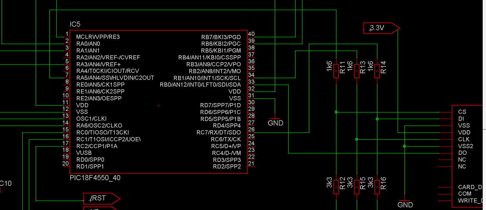

Well I have made a PCB that is purposbuilt for my application.
Im using the SPI pins (RB 0,1 and 4 (Using RB4 CSSPP as chip select) and RC7) I might have to change my CS pin to RA5

Here is the connections between the SD /MMC card holder and uC
(I think now that using a PIC18F425 could have been better :confused: )

If your running the 18F425 at 5V and the SD card at 3.3V you'll probably need a 74HCT125 or the like as a level converter as the SDI pin is ST (3.3V is too low)
The schematic below is for an AVR but the idea is the same.
It's not recommended, the ST inputs want higher than 3.3V when the hardware SPI is used. Check the electrical specifications of the datasheet.
https://www.electro-tech-online.com/custompdfs/2008/05/pic10t-20-1.pdf
thank you for clearing it up .. so .. it actually should not work, or at least it is not recommended ... the interesting thing is, now I get the reason why "Write" always work and "read" fails from time to time with no apparent reason (output from pic is divided with R1 trough R6 so SD receives 3.3V, but PIC does not always catch that 3.3V as "on") .. in general, this schematic ( https://www.electro-tech-online.com/custompdfs/2008/05/mmc-sd_board_schematic-2.pdf ) should have some 3.3->5V logic conversion on Dout from SD card for it to work "properly"
