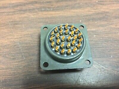

You are not likely to get one particularly cheap though; the cheapest I can find is about $50 for a pair of 26 way inserts.

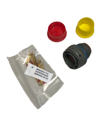

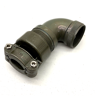

You need a size 16 angled backshell to go with the plug; the connectors themselves are the same, just the shell styles vary.
They also seem to sell for $30+

Search "mil connector 16-26" for the plug and socket, or "mil backshell size 16" for the shells.
There are other size combinations but 16-26 seems to be commonest..

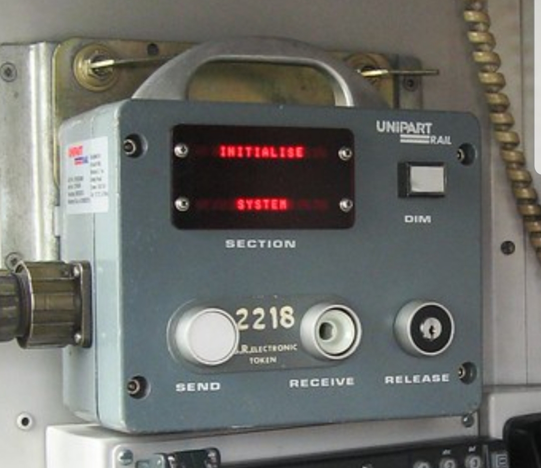

I came across these fitted to buses as an apprentice many many years ago, and was told by my boss at the time that they were military connectors... They were normally found on the gearbox "ecu" and associated wiring looms...

16 is the body size, 26 is number of pins; eg. the same body size & backshell could be used with inserts that have a lot of small signal contacts or a few high power contacts.

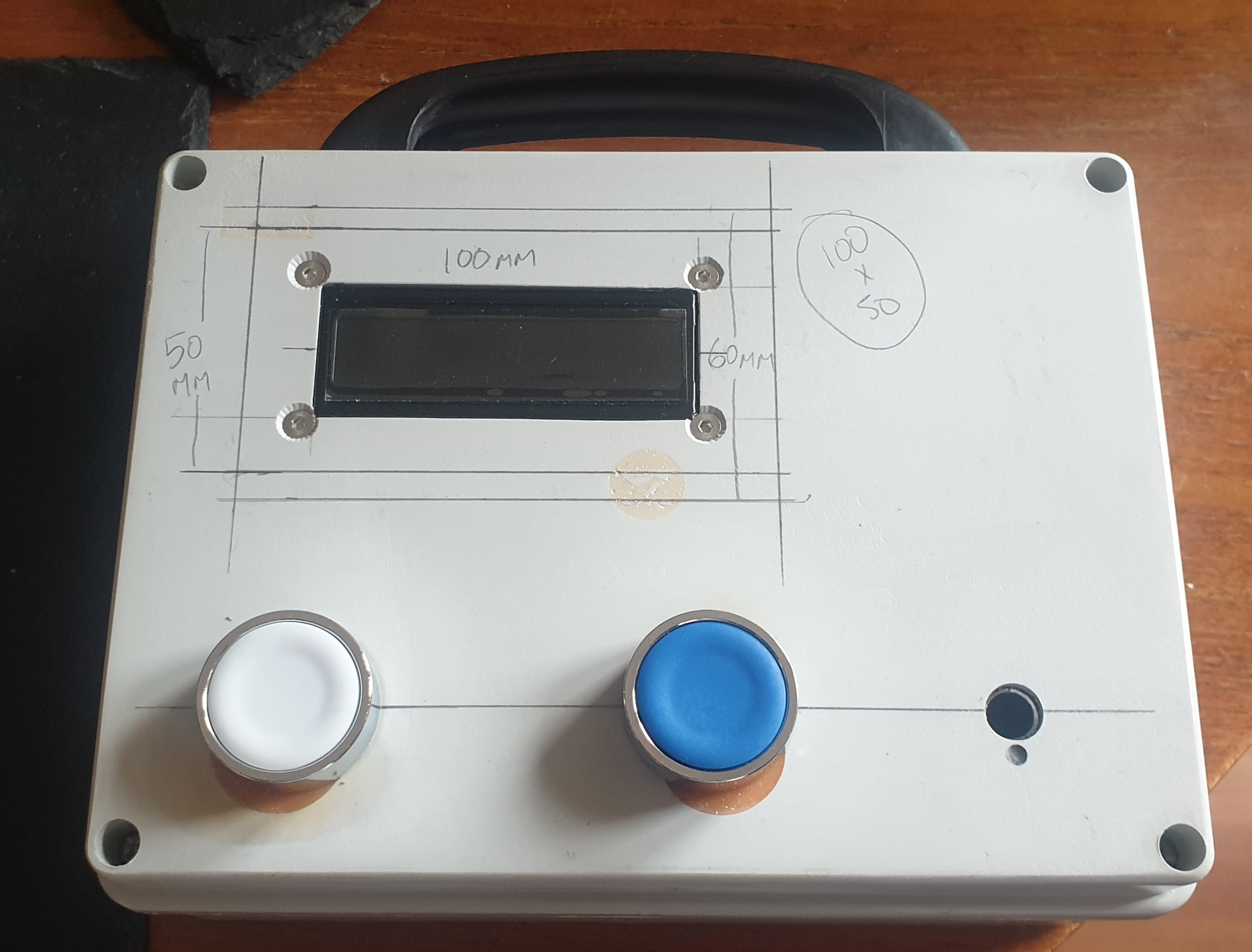

I only need a low voltage application but need to pass 20ish wires from an LCD display to an arduino... i know there's other options but want it to look like the thing I'm working on which is this:
and this is my (unfinished) effort so far:
Eric
