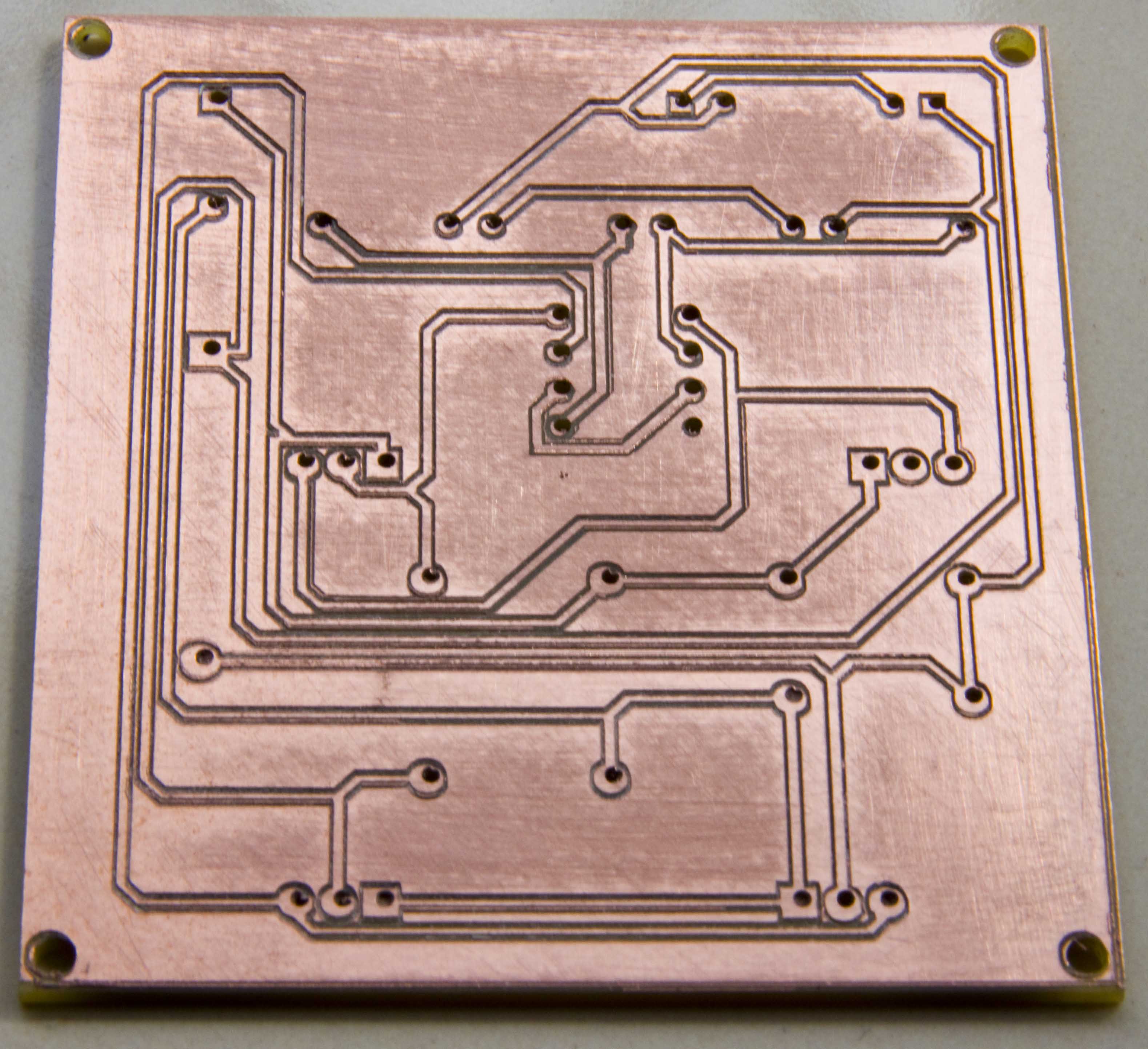

Well I've made (cut) my first board today.
Now while I enjoyed my self making this board I did find it very long winded

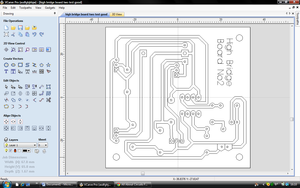

I drew my design in Diptrace and then exported it to a DXF file which sounds easy How ever when I opened it in my CAD program and VCARVE PRO I was faced with single lines for my traces. Now faced with single lines I just offset them inwards & outwards cool but it took for ever to do also at the end of the day my traces are all a bit close but I think usable but I will let you all be the judge of that. after I offset all the traces I went to my CAD program and added just the holes as on the vcarve drawing I deleted all the holes as I wanted it to be constant which worked very well.
I have to admit my first cut out of the traces was wrong I didn't mirror the drawing o'well you live and learn all in all it worked out quite well but could be a bit faster next time.

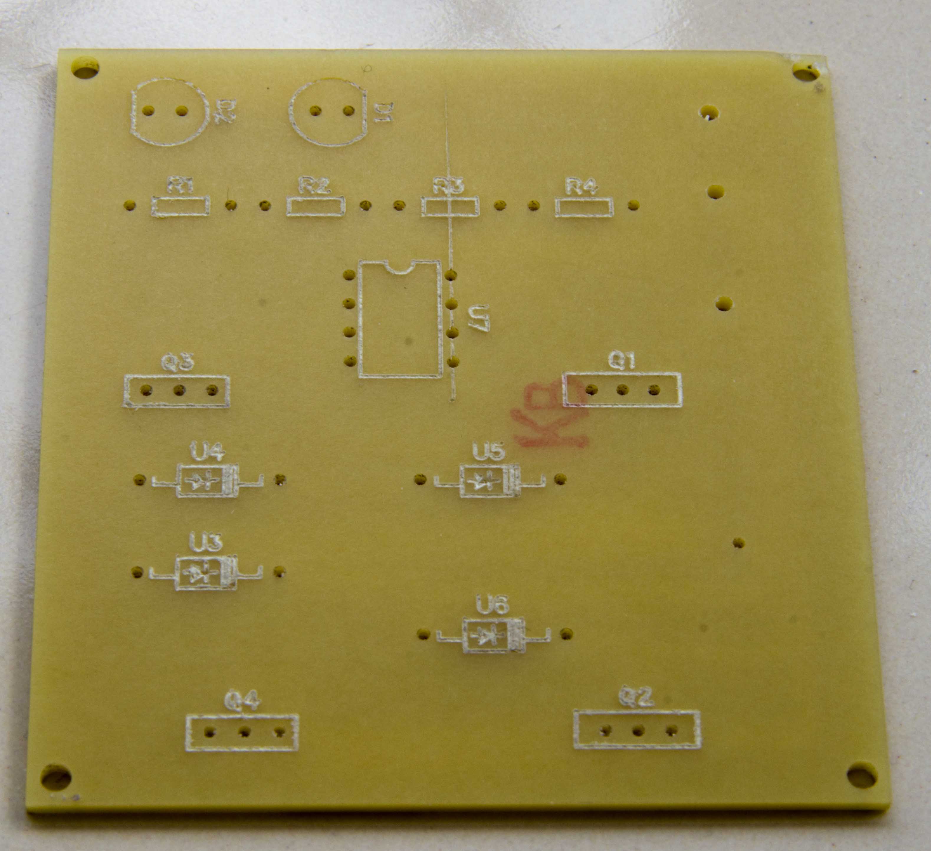

I even got cocky and engraved the parts to the top, next time I will spray the top with white paint first and then engrave.
I think I broke two of all my cutters doing this
2 .01 20 deg engraver
2 0.80 end mills
2 2 mm endmill for cutting out the board and Location holes
I think next time I'm going to try and change trace and pad sizes esp on the resistors, diode's,motor,power,LDR also the power amps but for a first go I think I've made a good start
it feels quite nice to have made my first board

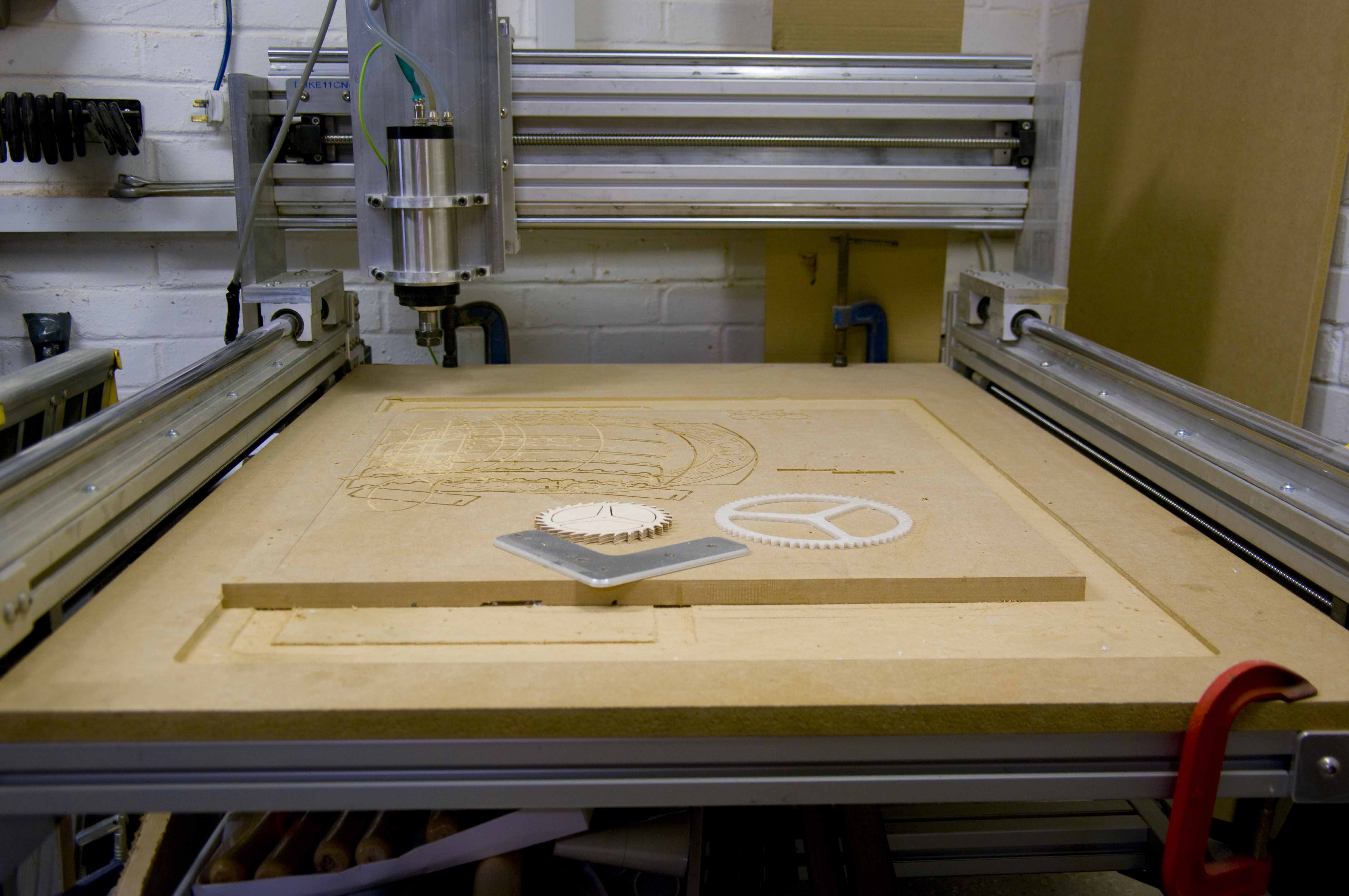

Plus I did it on my own CNC machine. I spent all weekend making a vac bed for my machine that didn't work how I wanted it to, My PCB board was to bent for the vac to work. with this in mind I'm going to increase the size of the intake holes from 6 mm to a whopping 32 mm as I have some old pvc pip in the garage.
but the board I made did benefit from the flat vac bed.

Congrats! That's not bad for a first PCB. :)

Do you have a photo of your CNC machine? :)
You might have gone a bit deep with the engraving, based on some other examples I have seen;

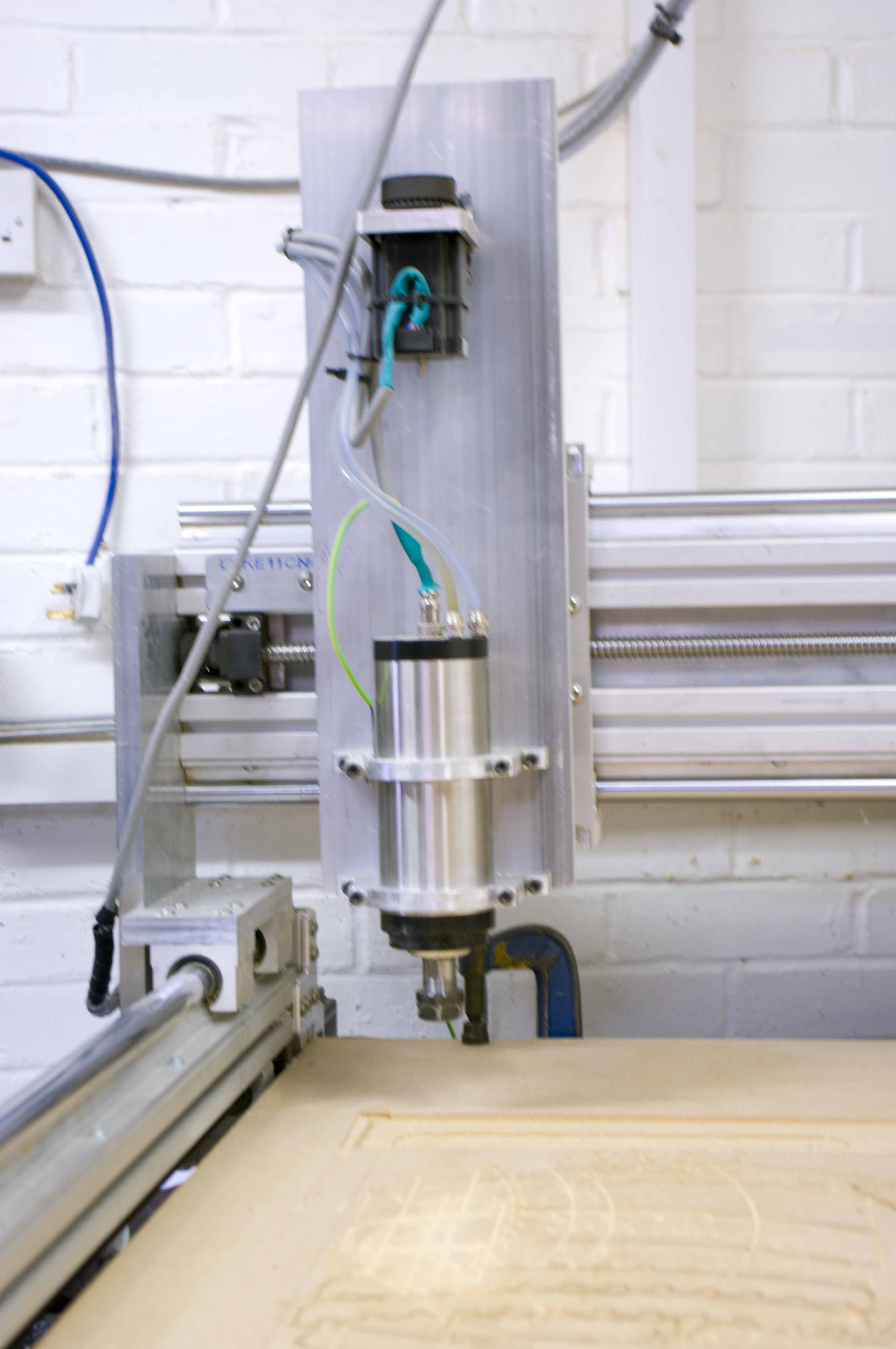

here is my CNC Machine made with my son over the summer holidays last year
the spindle is a 2.2kw water cooled with VSC with a cutting area of 960 mm x 840 mm and run with mach3

Nice board!
Provided the pcb edges have air-tight seals to the vac table that won't increase the flattening force on the pcb; it will only increase the pump-down speed. What is you vac source?

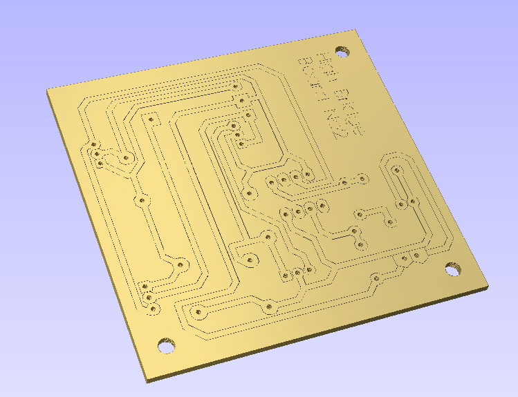

Well on to the reason I started to write this post/reply is I think I’ve found a better way of making my boards, well the process of drawing and writing the gcode first I altered my trace size and hole size changed ic contacts to oval pads which gives me more area to solder too.
So after I have designed my PCB I have saved it to gerber file and then open it in gerv program and save this as a PDF then convert the PDF to Jpeg after this I can open it in Vcarve.
When I get to Vcarve I can then draw the vectors straight from the Jpg File. From there it’s easy to generate the Vectors with a couple of clicks of the mouse done the first time I did this I used blue image and found I had to clean up my vectors a little bit but it worked out quite nice next time I'm going to use BLACK and convert PDF to Jpg in photoshop (better black and white control)
Here is a screen shot of my vectors
the vac I'm using is a RSDE1
