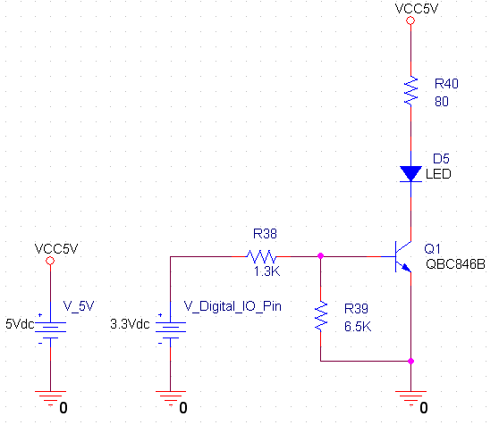

Hey,
I have a question regarding Min,Typ,Max values.

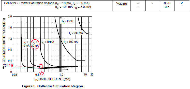

I designed a simple LED driver circuit:
led_driver_circuit-png.46185
VF = [3.3V(Typ), 4.1V(Max)] @ 20mA.
VCE(SAT) characteristics are as follows (I'm interested in IC=20mA):
untitled-png.46184
According to what VF and VCE(SAT) would you calculate the current limiting resistor?
Thank you :)

Yup, just ignore it.
But you could figure it out though by just using Kirchoff's voltage law and very basic circuit analysis fundamentals. Using V=IR around the circuit loop...
R = (Voltage across the resistor)/Iled = (Vcc-Vss-Vled-Vce_sat)/Iled
But Vce_sat << Vcc-Vss-Vce_sat so you can just ignore Vce_sat and treat it as zero. In english, it the transistor will reduce the voltage drop across the resistor a little bit. So your resistor can be a little bit smaller.
You should learn how you come up with the current limiting resistor is sized because its really fundamental and really simple. It's not something you should memorize because it's something you should know well enough that you can just look at the circuit and write it down without memorizing or thinking about it too much.
I would ignore the transistor entirely, just calculate the resistor based on the voltage drop across the LED - the tiny drop across a saturated transistor is far too small to bother about.

What value of VF would you take when calculating current limiting resistor's resistance?
Thanks guys.
If you really want to be pedantic you could consult the graph from the datasheet and see what value it shows for the current you are going to use. But really it's a complete waste of time :D
It's VERY, VERY, VERY unimportant - a huge range of values will work - personally (if I was going to calculate a value at all) I'd just assume 2V drop, so 3V left and whatever current you were thinking of. I certainly wouldn't get out pencil and paper, or a calculator - 1K would give you 3mA, so 330 would give you 10mA - it's as easy as that.

How come it's not important.
The graph you mentioned of IF VS VF shows that for 20mA IF you get 3.3V VF.
However, the table states that
VF = 3.3V TYP @ IF = 20mA ---> R(LED) = (5V-3.3V)/20mA = 85Ω
and
VF = 4.1V MAX @ IF = 20mA ---> R(LED) = (5V-4.1V)/20mA = 45Ω
It makes a large difference as you can see.

Fit either of those resistors, and the LED will light up - what's the problem? :D
For roughly 20mA I've have stuck a 150 ohm in.
The problem is that this LED is going to be placed inside a product.
I need to order many units of R(LED) and send them for assembly done by a factory.
So I want to know what value of R(LED) would give good brightness and will not damage the LED.
All the values I've suggested will - as I said it's EXTREMELY non-critical.
Frist thing you need to think about is how bright you want it - this is obviously related to the current, but you've no way of knowing how bright a particular current will make it. So chuck a resistor in and see how bright it is, if you then want it brighter then reduce the value, if it's too bright, then increase the value. Calculating doesn't really come in to it, as even if you knew how bright a specific current would be, I suspect the brightness value would be totally meaningless to you (it certainly would to me).
