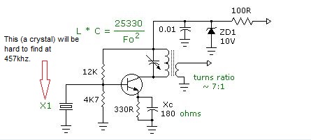

Hi guy' iam trying to make a mini transmitter that can fit in side a tv coax plug it does not need to transmitter far only about 8ft and transmit on 120khz, or 457khz,
any help would be very much appreciated,
Tire pressure xmitters use 125khz. There are ICs available for that.
Why such a low frequency? The antennas will need to be very long so you might as well connect with wires.

I think it's 457khz, I have the receiver it's a ferret locator. I would like to try to make a transmitter for it .

If you want to build such a device, it would help us to know your current level of electronic experience, since building a reliable and (in your case) very small xmitter 0f this sort could be difficult.
Here is a simple, crystal controlled oscillator/transmitter circuit. Simple, but not all that easy to build:
I suggest crystal controlled as that is far simpler to build and have any real hope of signal stability.
Read this thread. Pay particular attention to the comments about antenna length/efficiency.
