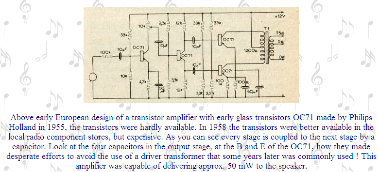

Here is the schematic of a 1955 Philips audio amplifier that used an expensive mini output transformer but they avoided using an expensive mini driver transformer:
A trip down memory lane there AG.
I think there is a mistake in that schematic, the OC71 is a PNP transistor, the power rail at the top of the schematic should be the -ve rail.
In a PNP, the collector is negative with respect to the emitter.
I agree that in 1955 Philips got the polarity of the battery wrong.
