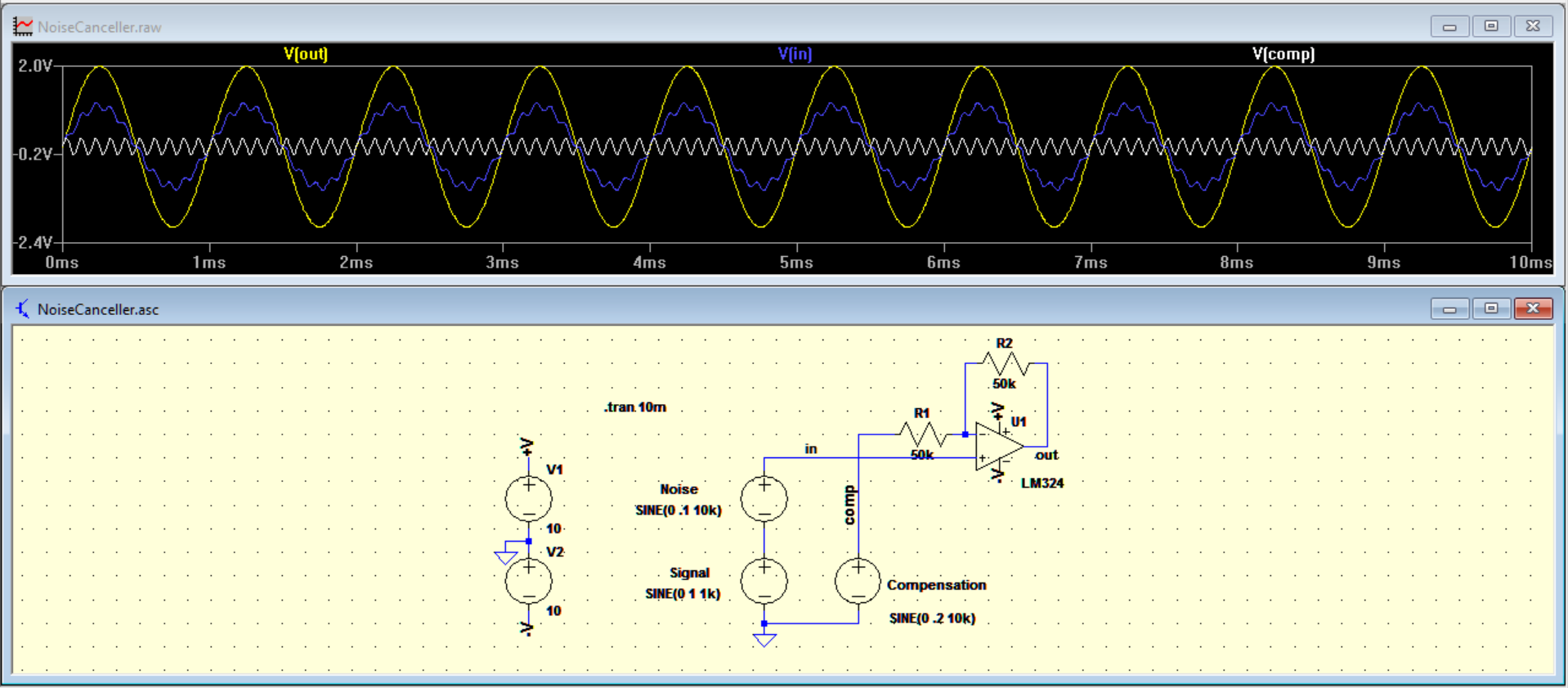

You might be able to subdue the 3kHz (or other) fixed component of the noise by a cancellation method in which you compensate for the noise by subtracting a noise sample from the noisy signal, like this :-

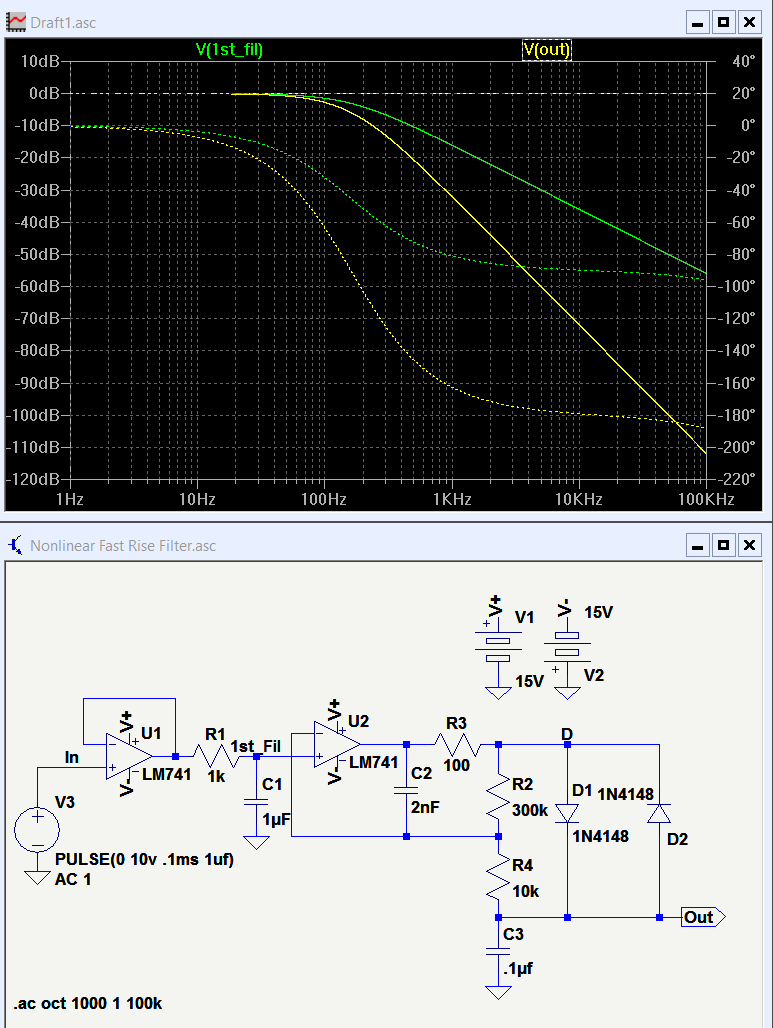

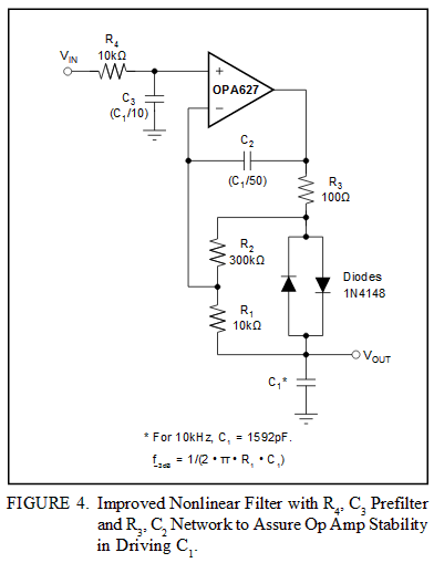

Ok so in simulation I was getting great results. Now in the lab I am getting 160kHz noise attached. The blue is the input and the yellow is the output. I also have attached the circuit I am using. The second low pass filter was taken from a TI paper which is here https://www.ti.com.cn/cn/lit/an/sboa011/sboa011.pdf
TYPO IN CIRCUIT R4 = 1k as well^^^^^^^^
ALSO THE OUTPUT IS BELOW THE DIODES AND A OVE THE C2 CAP

I don't like the filter.
U6 is a buffer.
R3, C1 is the only filter. What type of cap is C1? Why not 10k and 0.1uF?
U2 is not much of a filter. You can't get gain below 1 with a non inverting configuration. No help.
Are there any capacitors across the power supplies?
Why is 160khz passing through this "filter"?

I think the first amp is passing the 160khz. But it is unhappy with a 1k load. It is working very hard to push 160khz into a 1k load. This power is coming from the supply with out capacitors. You need caps!. It might be that this noise got onto your power supply and runs to the second amp and out.
Add supply caps and try increasing the resistor to 10k and reducing the cap.
ALSO Add another RC to the input of the first amp. Get the 160khz off the first amp.
Here's your circuit revised to the correct values for two 160Hz corner filters and the output taken from the output filter capacitor per the TI design, not the op amp output as you incorrectly show.
Don't know where you got your values for the non-linear filter. :confused:
Note that the output is high impedance so you may need to add another buffer amp.
I show it with the 741's you have, which has adequate frequency response, but you should use a better op amp to minimize low frequency amplifier noise.

Good catch! I implemented the correct circuit but the drawing i attached is incorrect and has a typo.
