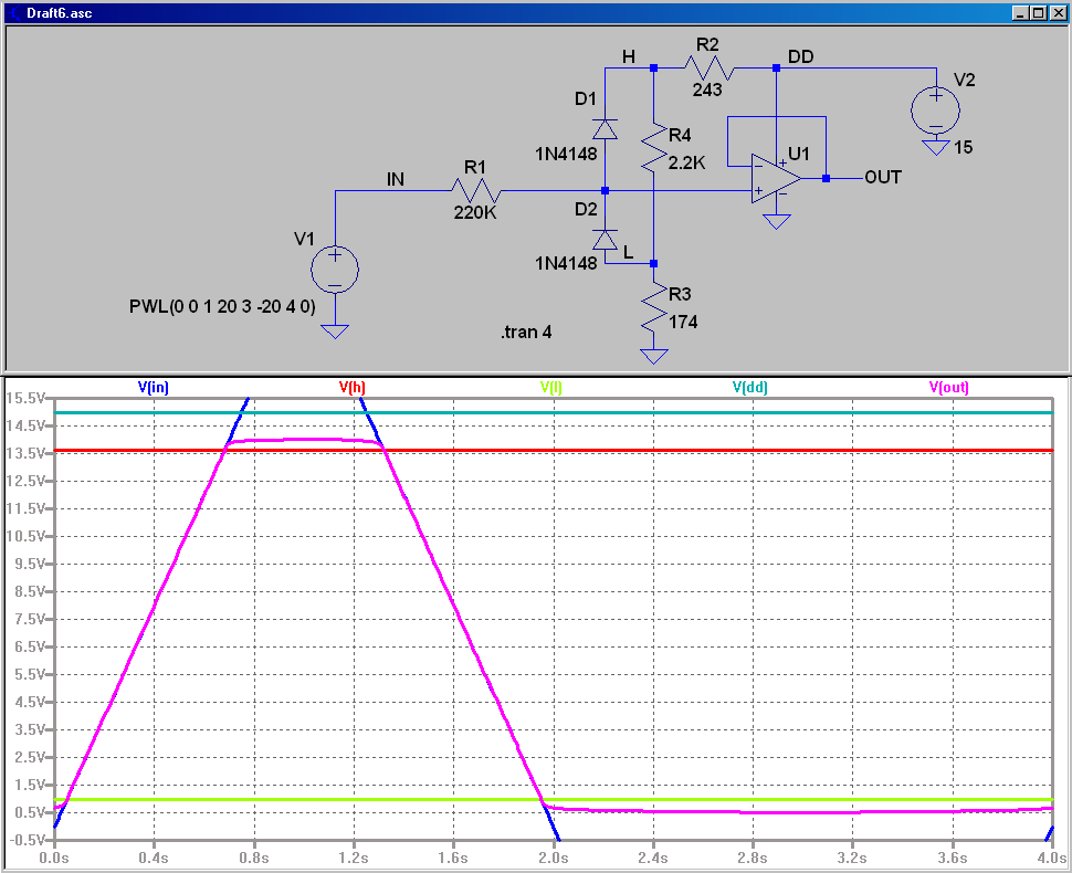

How about this:
So I implemented your circuit design and the concept is there but it is not clamping at the correct voltages...it is very close though. The upper limit is clamping around 13.1V in this circuit.
There is also more than a unity gain. I am inputting 1V into the circuit, which should give a 1V output, but instead I am measuring an output of 1.4V.

What is your supply voltage? How well regulated is it? What type of opamp are you using?
The two clamping voltages V(H) and V(L) are derived off the supply voltage. If it is different than 15V, you will have to adjust the voltage divider consisting of R2, R3, and R4. Note that the final clamped voltage is one diode drop above V(H) and one diode drop below V(L). Measure V(DD), V(H) and V(L)
Since the opamp voltage follower buffer has to swing from ~0.5V to 14V while being operated from Vss=0V and Vdd=15V, the opamp must be rail-to-rail inputs and rail-to-rail outputs. This precludes many common opamps, or you may have to use a dual supply with both positive and negative voltages.
I made the circuit using a dual supply +/-15V on the op-amp. My supply voltage is just coming from a lab power supply now to test the circuit. It will be coming from the output of a instrumentation amplifier though, which is why it will never be above 14V anyway, as I've discovered.
